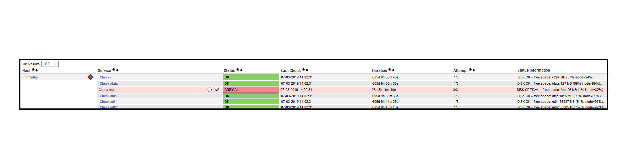

25 days ago, our Nagios Server issued a CRITICAL 'Check Disk' alert on the /opt (/dev/hd10opt) filesystem, indicating "DISK CRITICAL - free space: /opt 26 MB (1% inode=32%)"

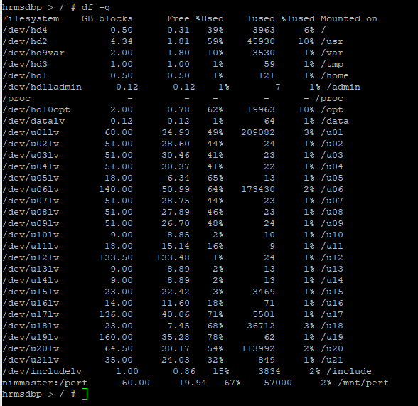

'df' on the LPAR showed that the /opt filesystem appeared to be fine:
hrmsdbp > / # df -g

I thought the issue was over-consumed and unreleased filesystem inodes, so I scheduled a maintenance window to reboot the LPAR.

Here is the current 'df -g' output from the system:
hrmsdbp > / # df -g

The filesystem isn't indicating that it is 95% full, nor that there are only 5% inodes left for the filesystem...
What gives?

This CRITICAL alert has been going on now for 28 days straight, and after the maintenance window reboot of the LPAR that I arranged for last week, I forced a re-check of the service from the Nagios Server GUI, and the CRITICAL alert never changed.
