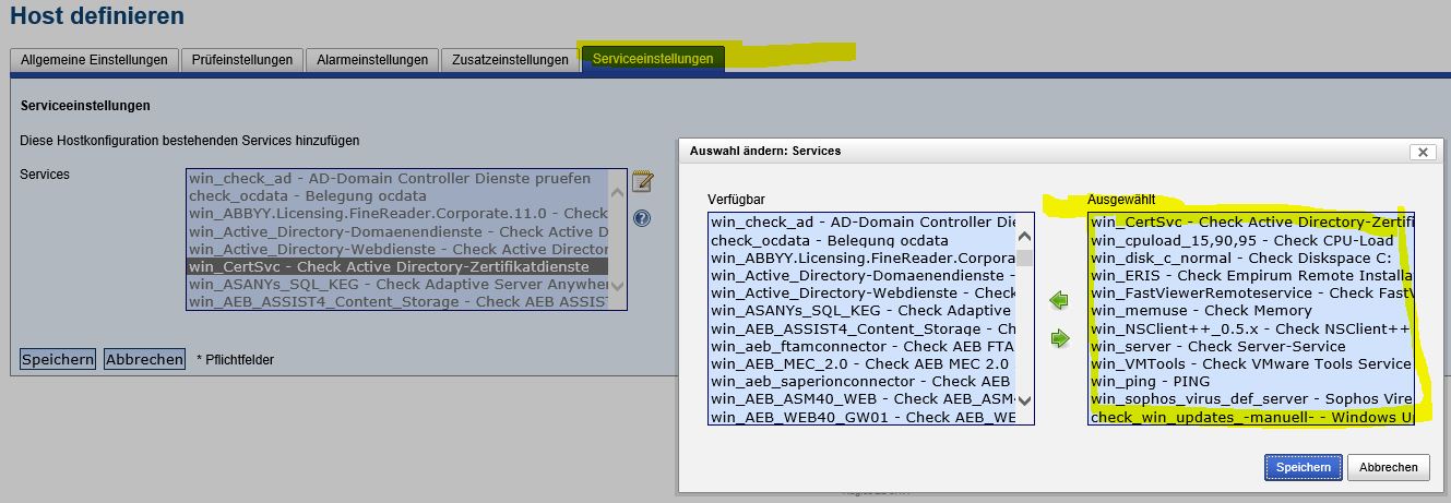

last week i change the settinngs so that i only put services in the service settings and not over hostgroups, see attachment.
On 15.09. 03:05 i get service notifications for server XENAPP02_Shop, see attachment.
My settings in Nagios QL is shown at the attachment too.
Any idea why that doesn't work that when a host is down that i get NO service notifications that are bind on that server?

My apologies, but not quite understanding what changes were made. Can post the configuration files for us to review? Thanks.last week i change the settinngs so that i only put services in the service settings and not over hostgroups, see attachment.

I mean that i put the services directly to a host, see attachment.
But if a host is down i still receive service notifications for that host.
I'd like to stop that.
