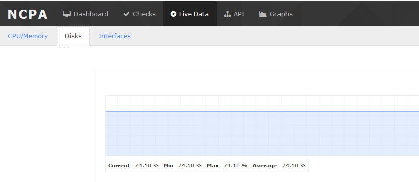

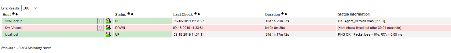

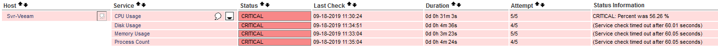

I did have one other question when I login to the NCPA interface, then I look at the Nagios server after the Nagios refreshe 90 seconds it shows that host as being down. Then the host does not change it status to up until I close the NCPA interface. Then after the 90 second refresh it show up.
Re: Trying to monitor disk with ncpa-2.1.9 on windows server
Alan wrote:I did have one other question when I login to the NCPA interface, then I look at the Nagios server after the Nagios refreshe 90 seconds it shows that host as being down. Then the host does not change it status to up until I close the NCPA interface. Then after the 90 second refresh it show up.
I've never seen this happen before, can you show the host detail page when it is showing down?

It is weird it only seems to happen when I go in to the live stats. When I sit on the Dashboard it does not seem to do it.
