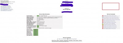

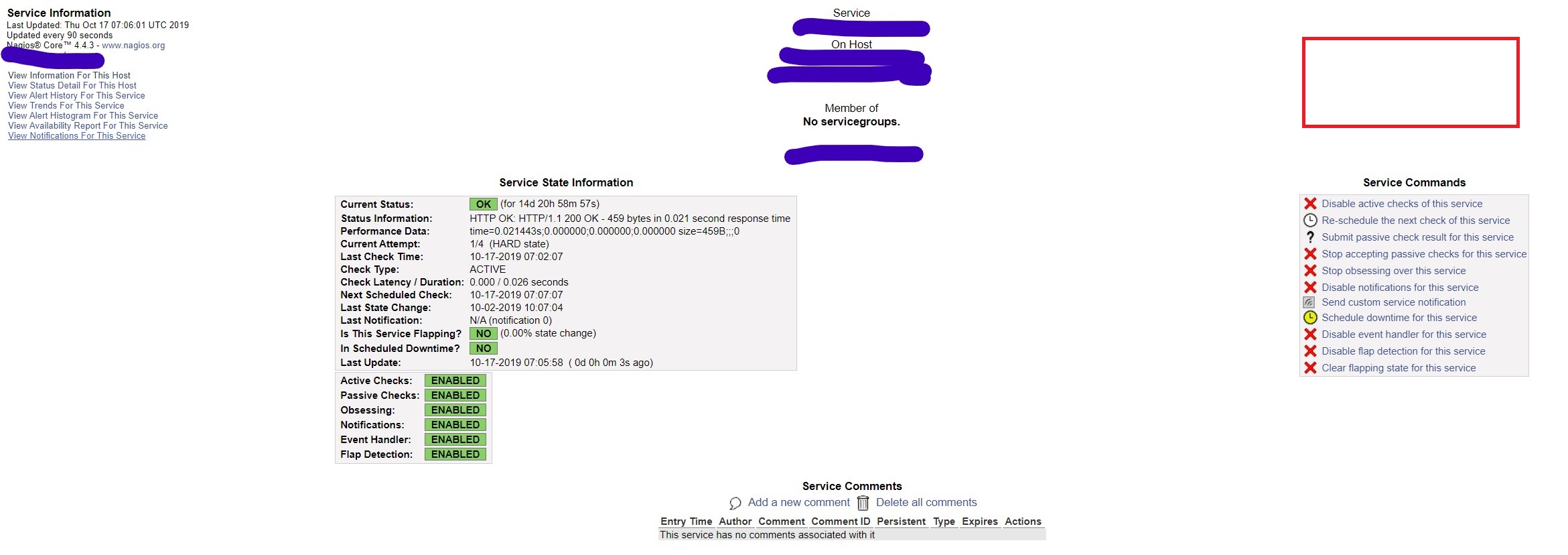

It's useful to have some embedded actions on each service, rather than searching on other areas. How can I embed an external URL or extra written information at the red box on the right top hand side (check attachment)? is it feasible?
thank you.

This won't go in the red box but will add an icon with the URL by adding the notes_url field to your host/service definition
https://assets.nagios.com/downloads/nag ... .html#host
Additionally you can add notes to the definition as well
