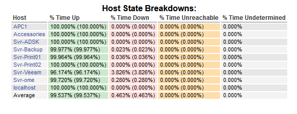

Ya the one I was looking at was the % Time Up and I did a test last night and turned off the Nagios service and then turned it back on this morning and you are right it did not seem to affect it. I absolutely did not think about the performance data though. So I am thinking at first just disabling the service to move off our old system and start to use Nagios full time but then just work on getting the Plugin to work. This host state Breakdowns is what I was looking to see if it affected the % Time up.
