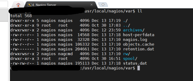

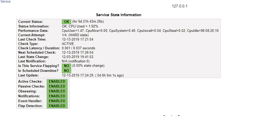

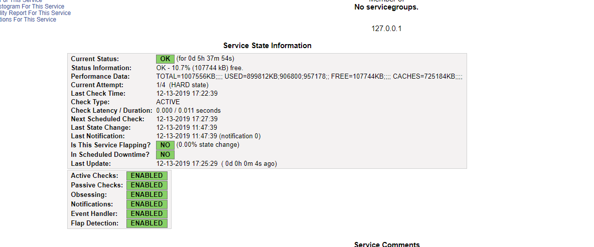

I'm trying to collect some performance data for Hosts and Services. All the services are showing Performance Data in the UI for Nagios Core but I don't see any files like service-perfdata, although the host-perfdata is there.

The Plugins are showing performance data:
1.What configuration or commands I need to ad for all the plugins and services to output performance data (i.e. for Disk, CPU, and Memory)?

I won't get the service-perfdata.out file.

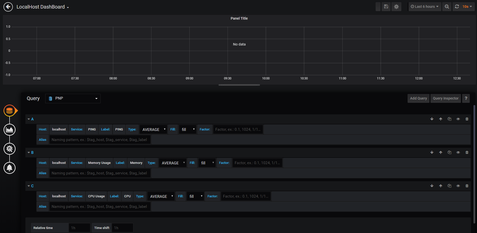

At the moment I installed Grafana over Nagios Core serverfollowing these instructions:
https://support.nagios.com/kb/article/n ... ana_Config

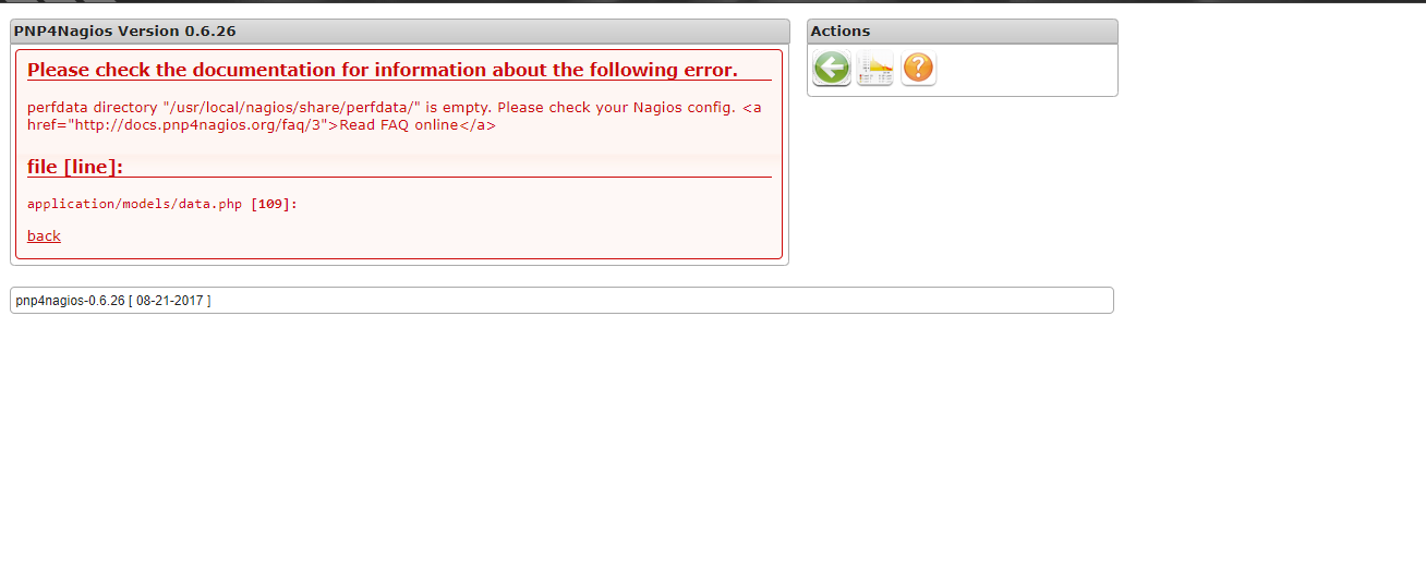

When I get to Adding a Query under "Grafana Configuration", I get an "Internal Server Error" pointing out the following:
p>perfdata directory "/usr/local/nagios/share/perfdata/" is empty. Please check your Nagios config.
The nagios.cfg is pointing to a different location:
host_perfdata_file=/usr/local/nagios/var/host-perfdata
service_perfdata_file=/usr/local/nagios/var/service-perfdata
Which location is the correct one for Nagios Core and for Grafana to pick it up properly?

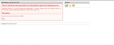

PNP4Nagios is installed as part of the manual I posted earlier(https://support.nagios.com/kb/article/n ... ana_Config).
I'm getting the same error when I go to [url]http://<nagios_ip>/pnp4nagios/index.php/graph[/url]
Please check the documentation for information about the following error.
perfdata directory "/usr/local/nagios/share/perfdata/" is empty. Please check your Nagios config. <a href="http://docs.pnp4nagios.org/faq/3">Read FAQ online</a>
file [line]:
application/models/data.php [109]:
Any ideas?

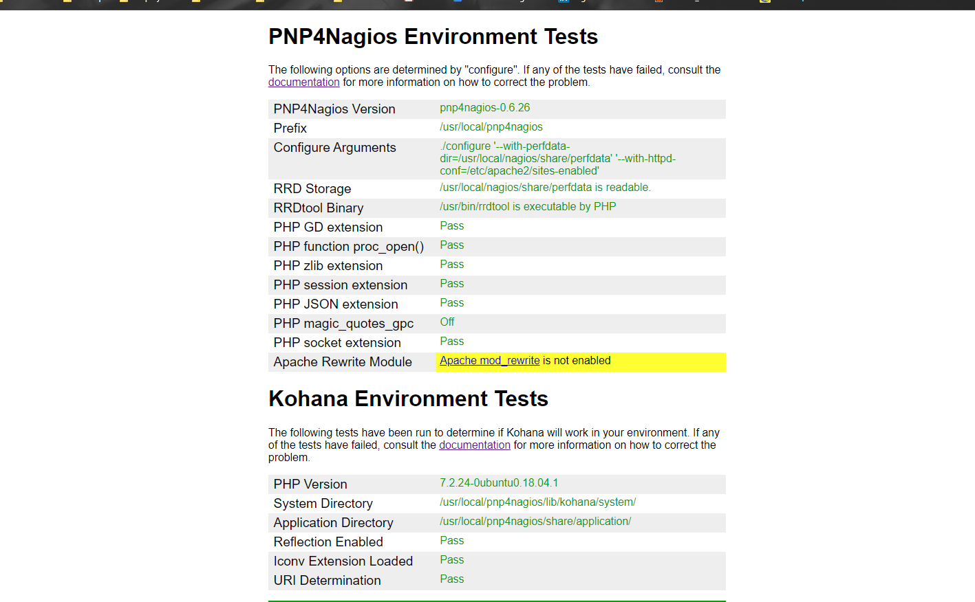

Installed pnp4nagios from here : http://docs.pnp4nagios.org/pnp-0.6/install
Enable the configuration for Bulk Mode with NPCD :http://docs.pnp4nagios.org/pnp-0.6/conf ... _with_npcd
It seems to work now
Re-installed Grafana as per https://support.nagios.com/kb/article/n ... ana_Config
I'm not getting any Data in Grafana

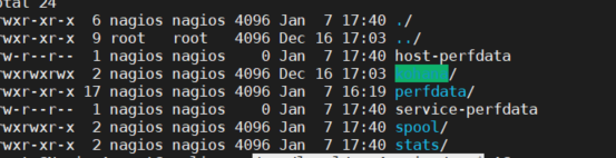

All the files are present in this folder: /usr/local/pnp4nagios/var
What did I miss here?
Re: Service Performance Data not showing for Nagios plugins
Do you see the rrd files getting created in the sub folders of this folder?
/usr/local/pnp4nagios/var/perfdata/
Or are the files in the sub folders of this folder?
What OS and Release is the server running?
