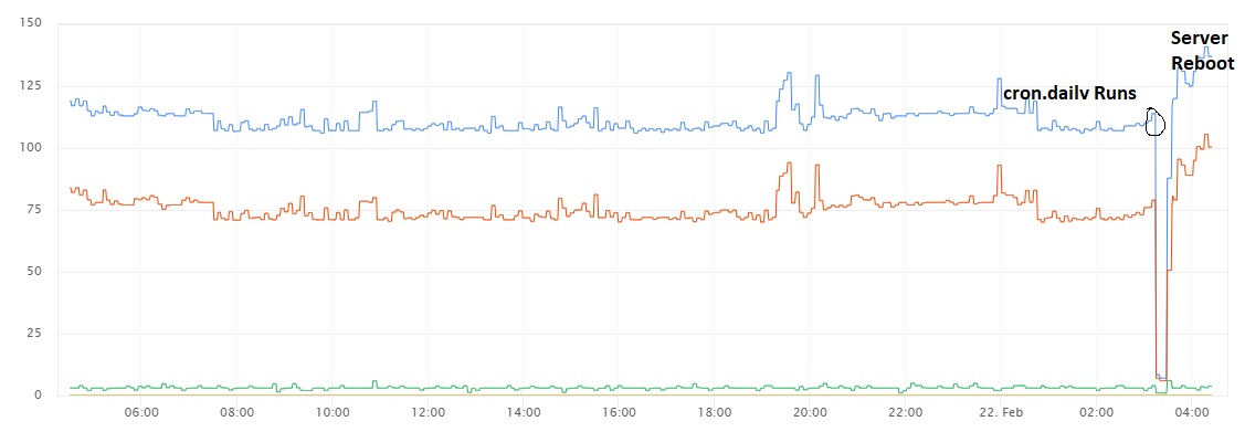

davidrk
Posts: 7
Joined: Sat Feb 01, 2020 9:44 pm
Location: Oak Ridge, TN
Re: check_all_procs start reporting wrong every morning arou
Post by davidrk »
Here is the graph from Nagios.
Weird.
All is well after a manually reboot of the server.
Posts: 5126
Post by Box293 »
This completely seems like an issue on your servers and nothing to do with Nagios.
