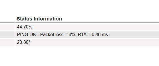

Iam using Nagios Core on a Raspberry Pi with Raspbian and i want to monitor the temperature and humidity of a room.
So i installed wiring pi and dht22 for the dht22 sensor. Also i created a script for it, a command and the host with the services.
So far everything works fine and i got no problems.
When i run the script in the command line, it works, i got the values for the temperature and humidity.
But in the web interface i have the message: no output returned from plugin.
What have I do, that i can see the values also in the web interface.

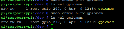

I got the message: wiringPiSetup: Unable to open /dev/mem or /dev/gpiomem: Permission denied.
So i changed the permissions and now it works.
Thank you!
