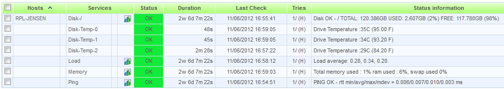

I have got the following script called 'check_serveraid.sh':
#! /bin/sh
cd /opt/MegaRAID/MegaCli/
./MegaCli64 -PDInfo -PhysDrv [$1:$2] -aALL | grep -e 'Drive Temperature'
As an example, when you run './check_serveraid.sh 252 0' from the plugins directory you get the following output:
Drive Temperature :35C (95.00 F)
I have created a check command and service and added the service to the local host but get the following which is, I assume, because of the format of the output:
So, a couple of questions:
1) Could anyone give me an example of how I could just output the 35C value of the script output?
2) I can run this script locally but obviously won't be able to run on remote machines. How could I change this?
Thanks.

What are the permissions of your file? Can you run this script as nagios user?
-rwxrwxr-x 1 nagios nagios      85 Jun  1 08:41 check_serveraid.sh
I have also moved the MegaCli64 executable to the plugins directory and changed the owner / permissions:
-rwxr-xr-x 1 nagios nagios 2570568 Jun  1 08:40 MegaCli64
You will have to install it on the remote machine and then use check_nrpe or check_by_ssh, whichever is applicable to your setup.
Thanks for this info. I'll try check_by_ssh when it works on the local server.
Any further ideas why I keep getting (null)?

Hmm, if I run:
su root -s /bin/bash -c "./check_serveraid.sh 252 0"
I get:
Drive Temperature :36C (96.80 F)
However, if I run:
su nagios -s /bin/bash -c "./check_serveraid.sh 252 0"
I get no output :(
Any ideas how I can fault find this?
Thanks.

You could give the nagios user permission to run MegaCLI64 as root. First of all, if you're not familiar with how to use the vi text editor, you'll want to run 'export VISUAL=nano'. Then run 'visudo' and add the following line to the file that comes up:
nagios ALL = NOPASSWD: /opt/MegaRAID/MegaCLI/MegaCli64
Then change your script to use sudo:
#! /bin/sh
sudo ./MegaCli64 -PDInfo -PhysDrv [$1:$2] -aALL | grep -e 'Drive Temperature'

Used vi to modify VISUDO and added the following line as directed:
Then I modified the check_serveraid.sh script to the following:
#! /bin/sh
Now when I run:
I just get the following:
[sudo] password for nagios:
Really confused :(

Sorry, spotted a mistake in the modification to VISUDO...
should actually be
nagios ALL = NOPASSWD: /opt/MegaRAID/MegaCli/MegaCli64
Just a cAsE issue :)
Thanks.
