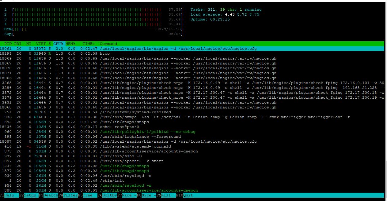

Post by ahiya »
hi
thank you for responding.

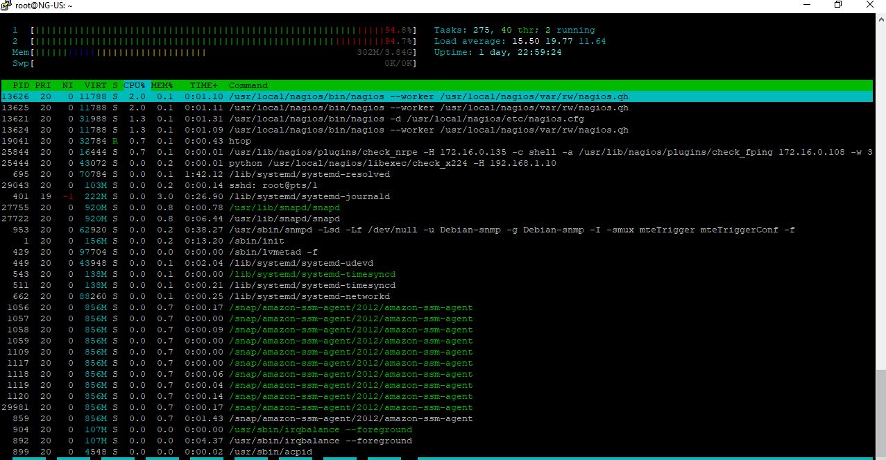

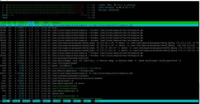

attached screen shots from htop. these with 1135 checks configured.
regarding the link you've recommended, ive already look at it and accordingly ive enabled the "large_installation_tweaks" and switched to use fping instead of ping.
any other recommendations i should use?
thanks

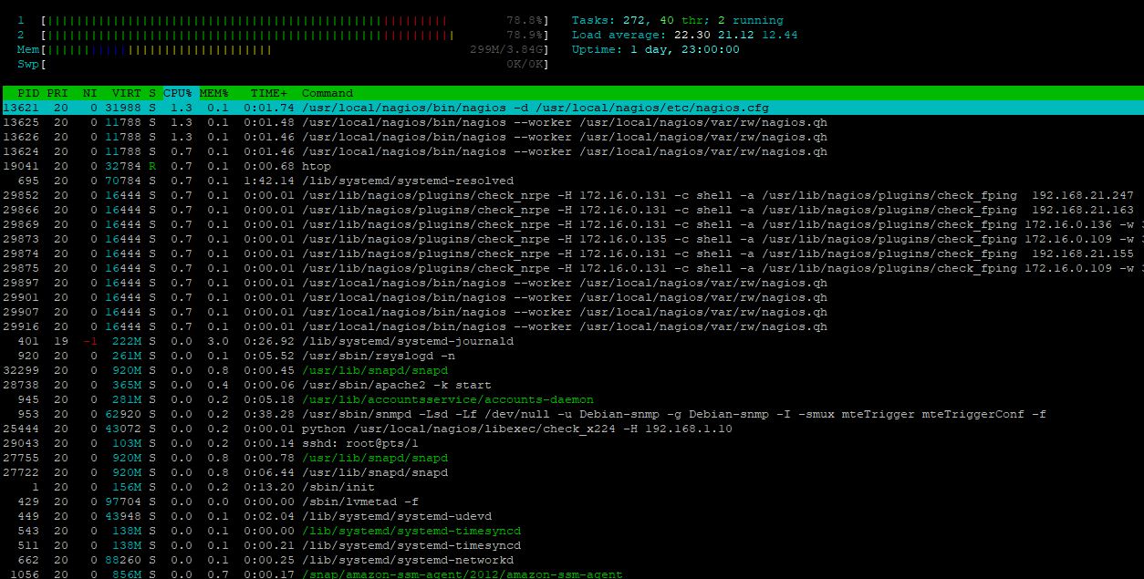

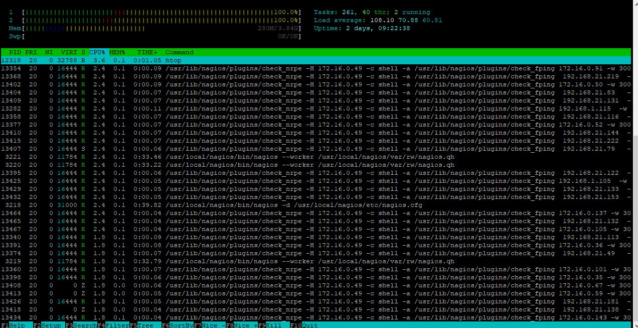

ahiya
Posts: 11
Joined: Wed Nov 20, 2019 1:04 am
Re: NRPE master high load issue
Post by ahiya »

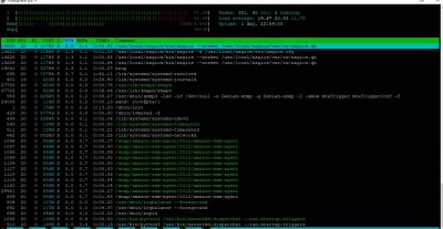

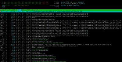

now its even worse

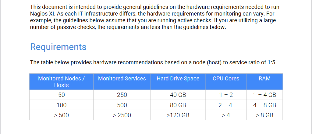

snapier3
Posts: 144
Joined: Tue Apr 23, 2019 7:12 pm
Post by snapier3 »
XI Server
2Cores 4gig Ram
1. Your instance is not right sized for your active monitoring load.
400 service checks (Active Monitoring via NRPE)
NagiosXI Server Specs
2. Your timing is very, very, very aggressive for an "Active" monitoring scenario IMHO.
Executing every 20 seconds with a retry interval of 10 seconds with 10 retry (Total time to incident is 2min)
The plugin timeout is 30 seconds (I think) which means you have the posibility of trying to execute the check twice before the first timeout is reached adding greater load to the system.
I know this is for XI but, I have noticed that you can only push past the 1:5 recommended ratio if you're at 8G> Ram.

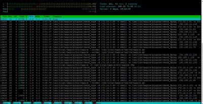

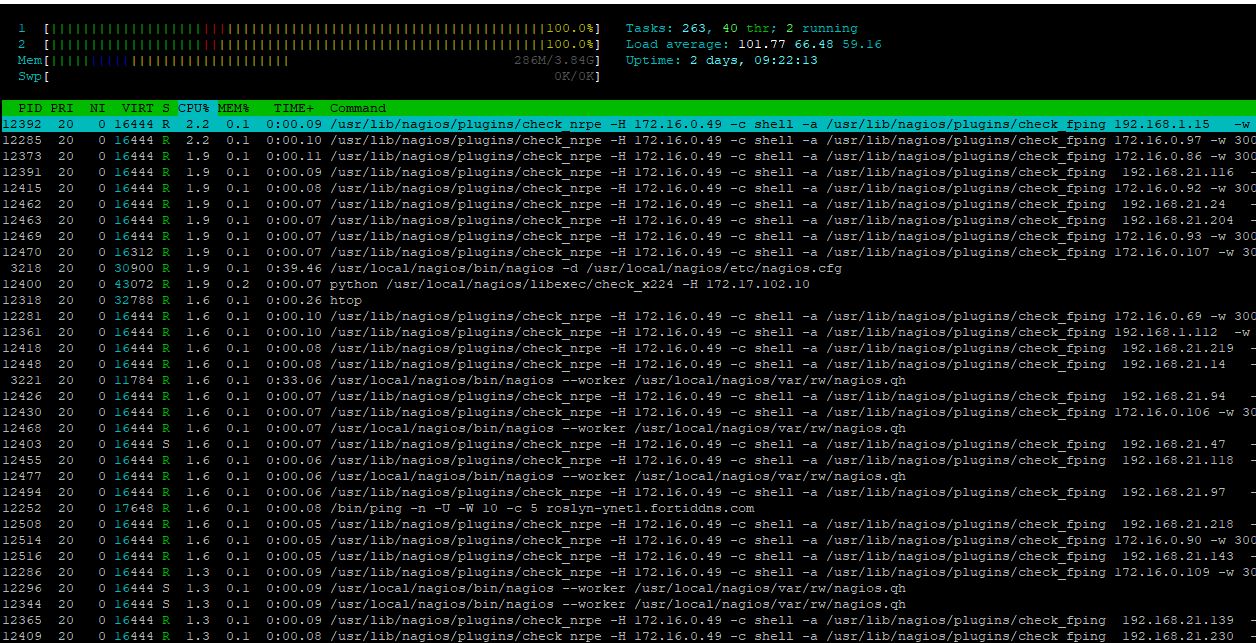

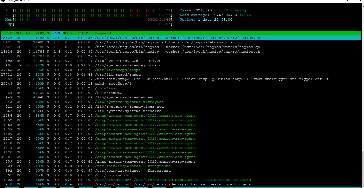

hi
after ive made some changes to my system
- increasing my server resources to- 4 cpu, 16G ram and 100G HD
- reconfigure workers number to 6 (4x1.5).
- change intervals to - check_interval of 1 min, retry_interval of 30 sec.
i still see my server cpu load jump to 80-100% every few minutes.
any idea how to proceed from here?
attache "htop" command screenshot
