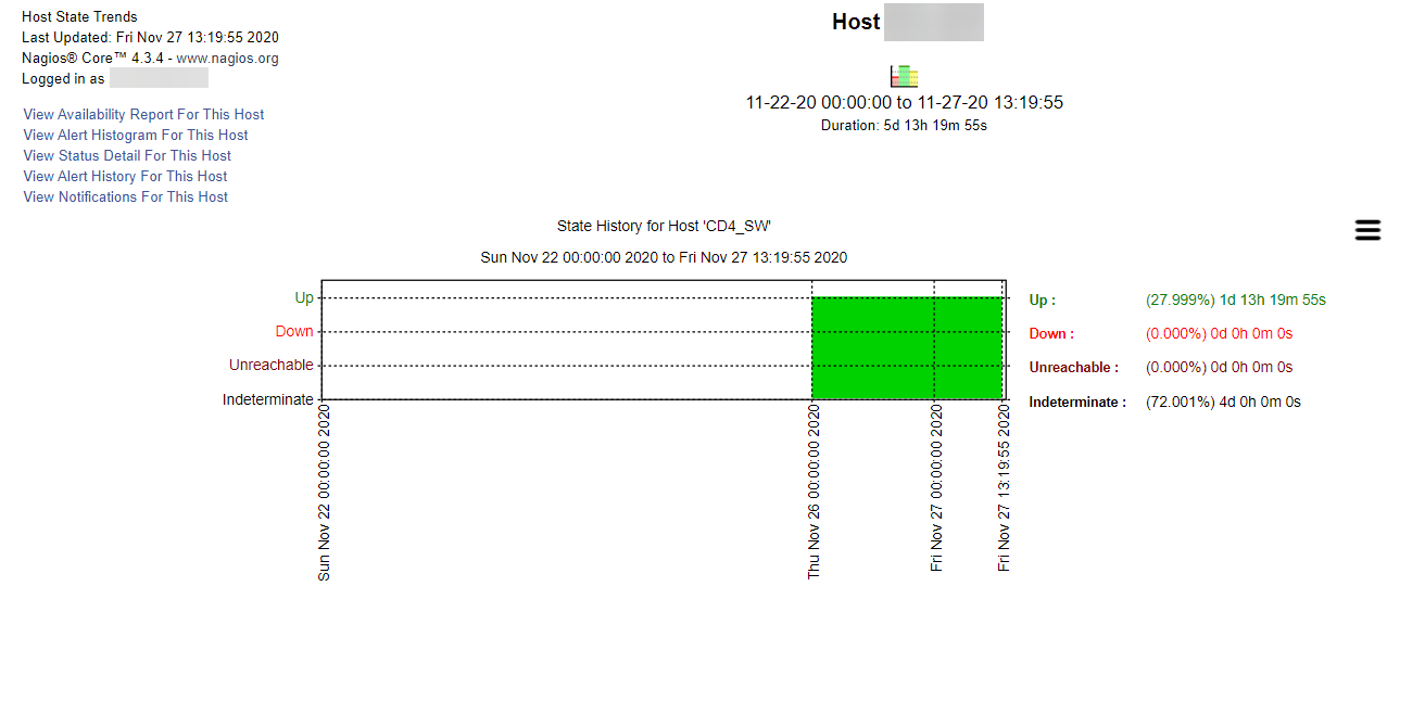

I've been using Nagios for a year and a half so far, and now I'm facing a problem with generating reports on Trends and Availability Report, both of them showing "Indeterminate" and "Insufficient Data", respectively, if the selected time period exceeds more than 48 hours.
I read in documentation that this is because Nagios can't find information for that host/service on a given time period. Please, correct me if I'm wrong about this.

So, I kindly ask for help here, because I don't know what else I can do, I'm stucked on this. I attached two screenshots of those reports, both for the same host, just to show the results. On both of them I backtracked 14 logs, but made no difference.

I figured out the problem. My logs are being named wrong.
I don't know why they're being named with the date appended at the end of the file, but that's the reason my reports (Trends and Availability) are being generated with so much time on "insufficient" or "indeterminate" states.
Thanks for your time and effort @Rfferrao13 !
For the mods, you can close this thread, because Nagios is working properly, only the rotation that is weird (you can see it on the above message), but I believe that it deserves its own thread, if I find anything worth to open a new one, of course.
Re: Indeterminted and Insufficient Data on Reports
This is very likley because you have logrotate rotating the logs which is changing the names. Nagios rotates its own logs and should not be done outside of the program
