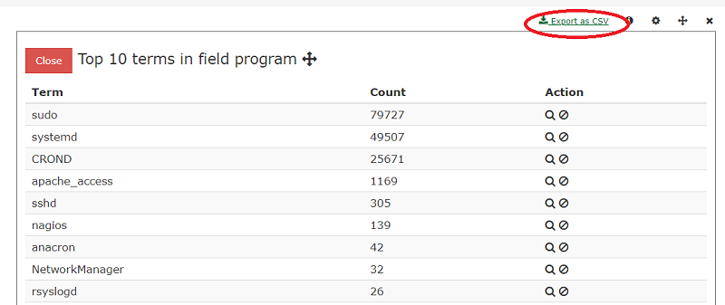

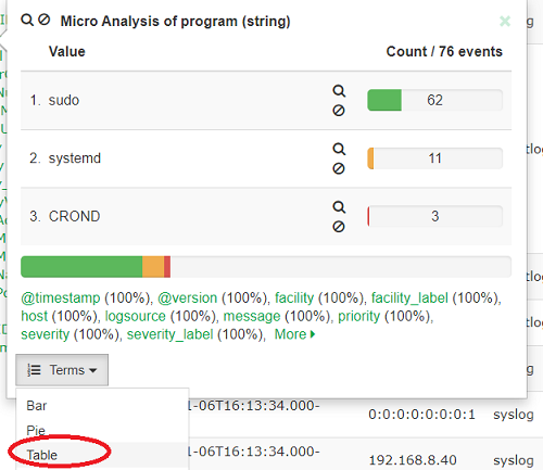

This method will only include the data in the current query, but if you set that to a large enough time frame it should be sufficient and is easy to do. Click on the program field on the left-hand side ( under All Events), and select the table option.
You will get a listing of the top terms based on count and then you can also download a csv file the whole query sorted by program filed.
