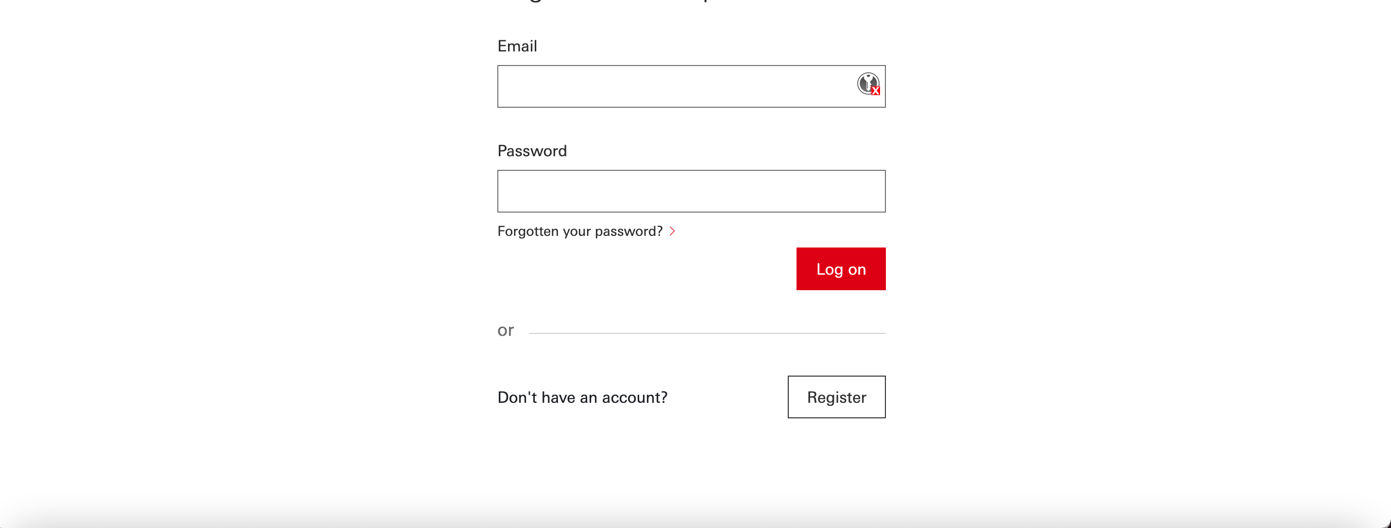

Thanks for the reply. I use [email protected]:test@1234 to log in to https://develop.mydomain.com/user/login. It works without issue.I am attaching the screenshot for your reference. [img][/img]

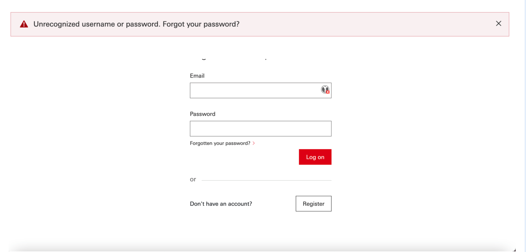

If I use the wrong password it will report an Unrecognized username or password. Forgot your password? I am attaching the screenshot for your reference.

Re: How to login in to http website and check the pages
You can try adding the -v flag to get more verbose output for what exactly check_http is doing:
You can also use -e flag to instead look for that "Unrecognized username or password" message in the response body:
Without knowing specifically how the form is meant to behave (like what the actual code being executed is), it's hard for me to offer much insight.
-v, --verbose
Show details for command-line debugging (Nagios may truncate output)
-s, --string=STRING
String to expect in the content
