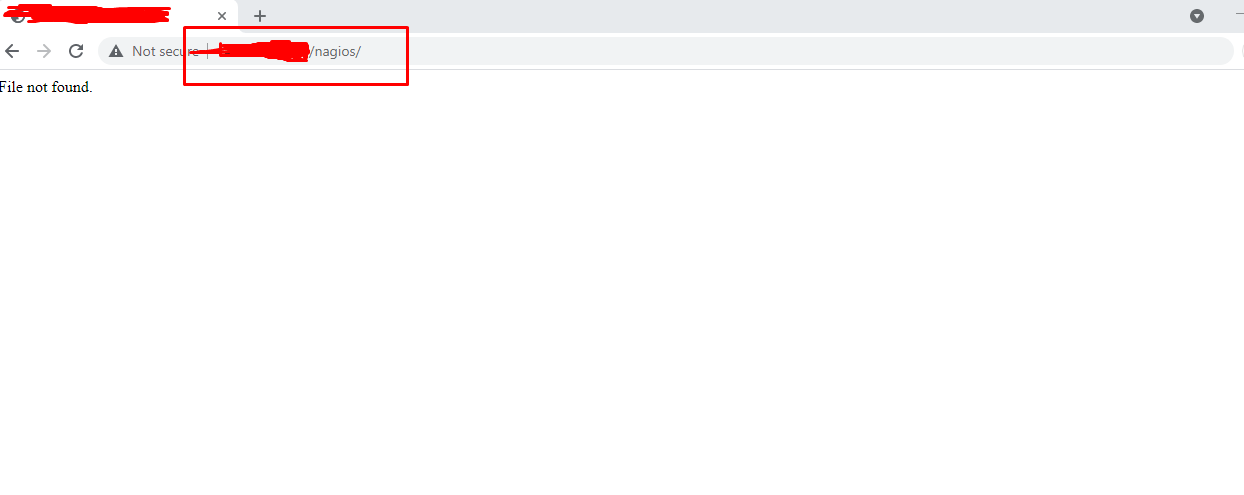

Nagios installed on centos 7 instance ,nagios is actively running in cli but in browser when i hit http://ip-address/nagios asking credentials then displaying "file not found".

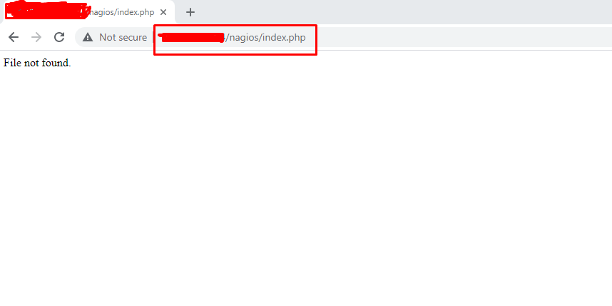

http://ip-address/nagios/index.php or map.php and some php files only displaying "file not found"

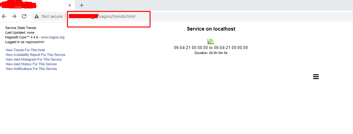

http://ip-address/nagios/trends.html or infobox.html... files working in browser.
/usr/local/nagios/share folder having html files as well as php files. why .php files are not working??
could you please help to fix this problem.
http://ip-address/nagios/trends.html shows web page of html file
http://ip-address/nagios/index.php shows "file not found"
nagios web interface http://ip-address/nagios shos "file not found"

Hi @Lavanya Andluru,
Welcome to the Nagios Community Forum. Here are few things to check to help resolve this error.
Is php installed in the server?
php -v
Next check that those files exist with the correct permissions on index.php and map.php.
ls -l /usr/local/nagios/share/map.php
Lastly, what instructions did you use to install Nagios Core. I highly recommend following our guide as we keep this up-to-date.
Nagios Core - Installing Nagios Core From Source
Let us know if you get it worked out.
