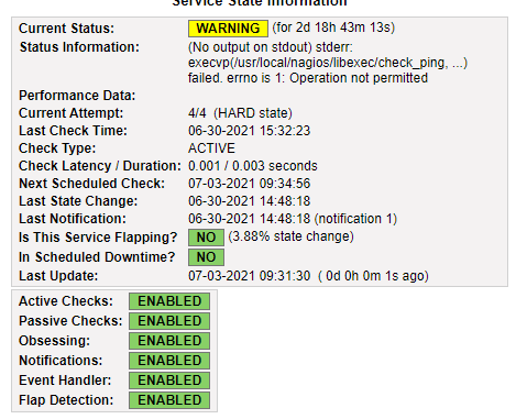

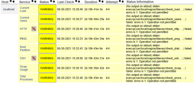

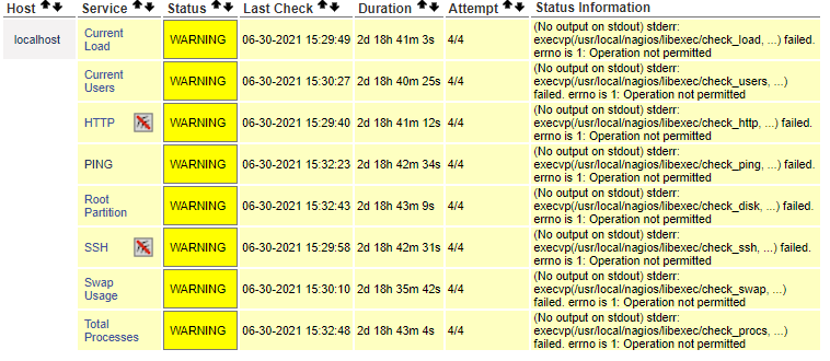

Strange thing happened. on the host page, I get a green saying up, but still get the same error:
(No output on stdout) stderr: execvp(/usr/local/nagios/libexec/check_ping, ...) failed. errno is 1: Operation not permitted
but the Ping service still show yellow with the same errors.
I added screen shots now
All services
All services
Ping service specific
Host page
Host page
