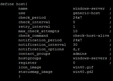

"Nagios Team,
I have just configured Nagios for my companies infrastructure and as this is my first time I am still getting to know the software. I have everything completed except one task and that is configuring the images for the map. I can’t seem to find any information on how you’re supposed to link the images to the web interface to be displayed. Thank you very much for your time and I look forward to hearing from you at your earliest convenience."
This was the email I sent them, they told me to come here! Please help good people, i've been rattling my brain and this computer to get this working properly!

Nevermind figured it out.
And for future readers who miss this small step please go to your templates.cfg and mirror my changes at the bottom with the
icon_image
statusmap_image
