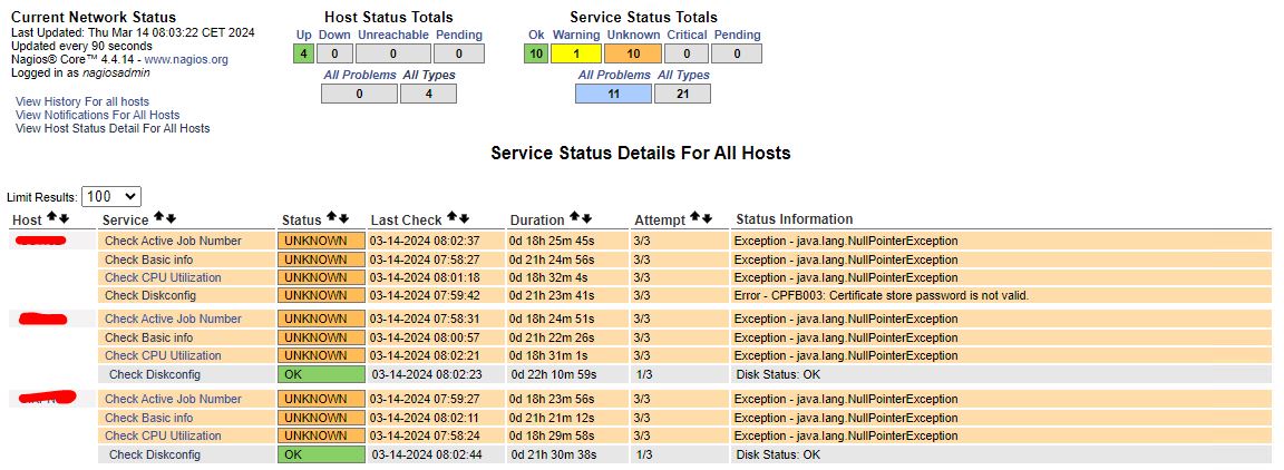

This service is also running okay on two of three hosts (one host gives an error "Error - CPFB003: Certificate store password is not valid. "

On the third host I get
[nagios@<nagioshost> objects]$ /bin/bash /usr/local/nagios/libexec/check_ibmi_status.sh -M DiskConfig -H 10.181.12.245
com.ibm.nagios.util.QYHCHCOP.run(QYHCHCOP.java:59)
com.ibm.nagios.service.impl.DiskConfig.execute(DiskConfig.java:63)
com.ibm.nagios.RequestHandler.CollectStatus(RequestHandler.java:29)
com.ibm.nagios.RequestHandler.process(RequestHandler.java:16)
com.ibm.nagios.CheckIBMiStatus.run(CheckIBMiStatus.java:18)
com.ibm.nagios.ConnectToSystem.run(ConnectToSystem.java:64)
java.base/java.util.concurrent.ThreadPoolExecutor.runWorker(ThreadPoolExecutor.java:1128)
java.base/java.util.concurrent.ThreadPoolExecutor$Worker.run(ThreadPoolExecutor.java:628)
java.base/java.lang.Thread.run(Thread.java:834)
[nagios@SUCENA53 objects]$
All other services aren't working at all, giving a java error.
Exception - java.lang.NullPointerException.
Al definitions are the same as the firts definition which is working okay.

When running the command directly from the commandline it al works perfectly
eg.
/bin/bash /usr/local/nagios/libexec/check_ibmi_status.sh -M BasicInfo -H <hostname>
Gives me the versionnumber of the systemsoftware running on that machine.
See attachment.
Hopefullly I described the problem clearly enough. If not please respond. Thanks in Advance.

I solved the problem. It has to be on de local host because the commands are working fine from the commandline.
My first definition (e.g. for basic info) in the cfg file was:
check_command check-ibmi-basic-info
That should be:
check_command check-ibmi-basic-info!BasicInfo
I don't see the logic of it and I will also not try to. But it works now.
Another example is :
Old:
check_command check-ibmi-cpu-utilization!80!90
Corrected:
check_command check-ibmi-cpu-utilization!CPU!80!90
In de cfg file you put on the check_command line de command ("check-ibmi-cpu-utilization") and the first parameter must be "CPU" and the second parameter must be warning-level and the third parameter must be the critical level in this case.
In my opinion it's a kind of double. "check-ibmi-cpu-utilization" and the first parameter "CPU". I thought is was clear that I want the cpu-utilization by using the command "check-ibmi-cpu-utilization" in stead of also adding the parameter "CPU".
But problem solved.
Hope this story is clear. If not please let me know by replying or pm me.
