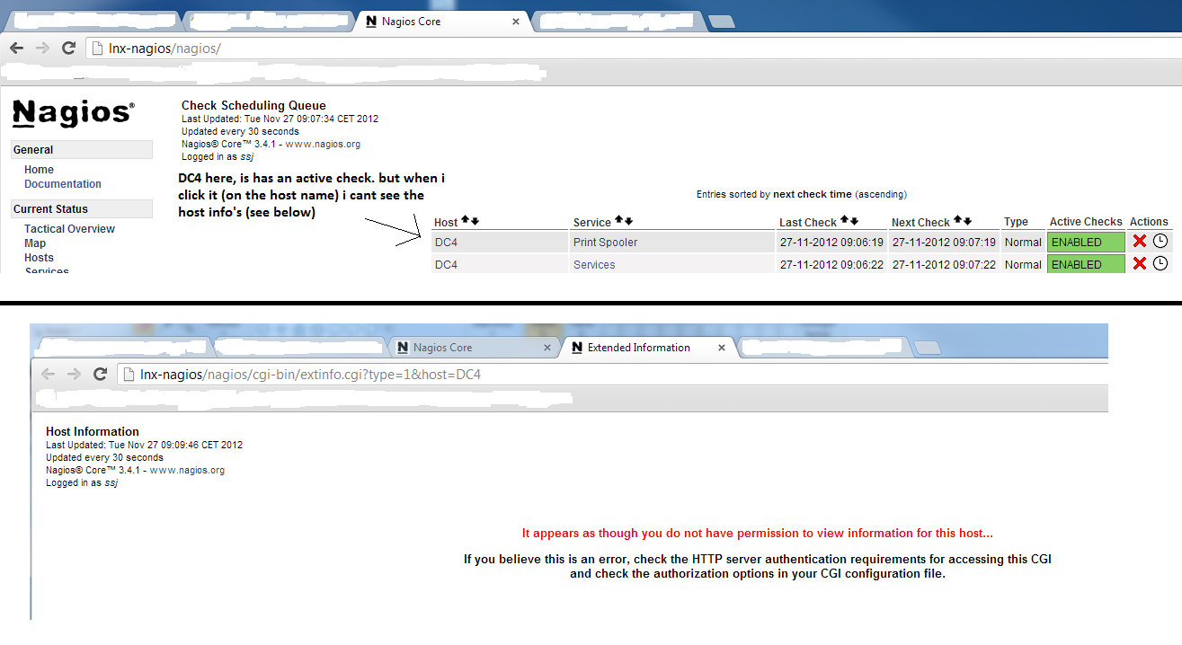

I think a pretty good way to describe it is to show you, so i made some screenshots of it and attached it to this post.
As you can see, there is executed active checks on the host named DC4. but if i click on the host, the host is not found in the web interface (if i search for DC4 in the menu to the left, i can't fint it either)
Hope this helps understanding the problem..

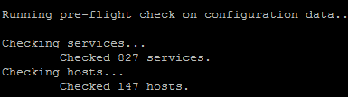

I just ran a check of the configuration files because i add'ed a new host like usual, and i noticed that it outputs a number of hosts, services, groups and so on. and to show you how many hosts my nagios configuration actually has i took a screenshot of this too.
As you can see i have 147 hosts, but my nagios web interface only shows 122 of theese.
