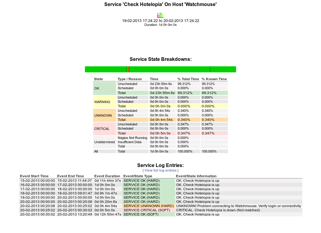

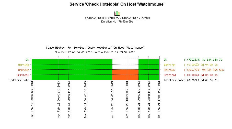

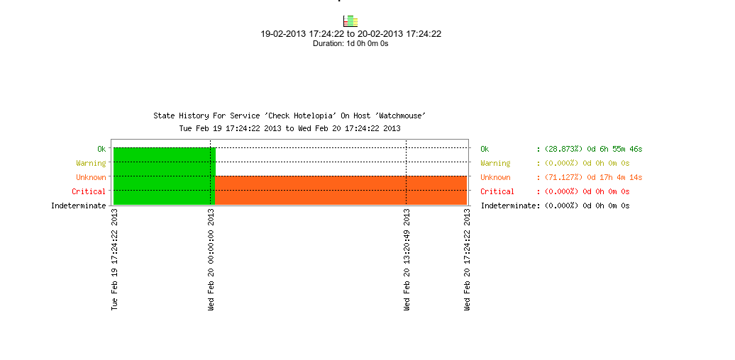

Hello, I've just seen some data that I think are wrong. See attached screenshots.
Last night we had a little network problem and that caused the service check fail, but immediately, on the next check he has recovered. Something curious happened, when you make a report(trend or availability for example) this service check are down for 13 or 15 hours, why?

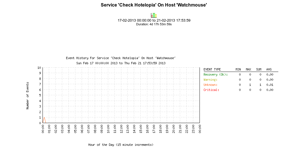

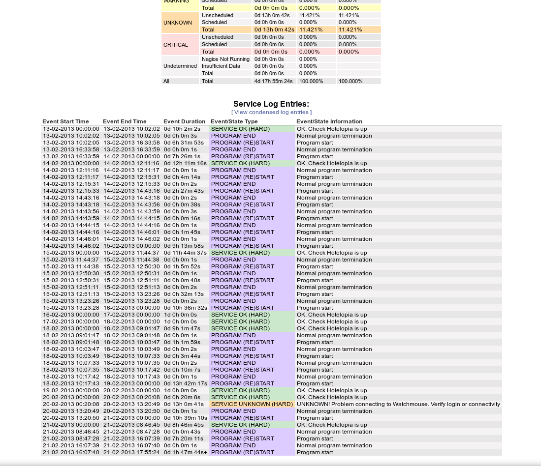

No, if you look "instantanea2.png" screenshot, the service doesn't has more events, that screenshot is a "alert history" of that service. There have been no changes to the remaining hours.
is strange

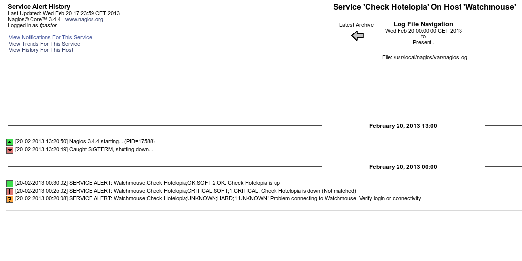

Yes slansing, we had correctly configurated flap detection, if you see the screenshot of "Alert History" look the events, if he had flapped we would see there.

Is suspect that if you look at the Trend Report, the service recovers at 00:00, but all day the check has been checked every 5 minutes checking and the result of all checks has been OK, only one CRITICAL at 00:20 +/-
