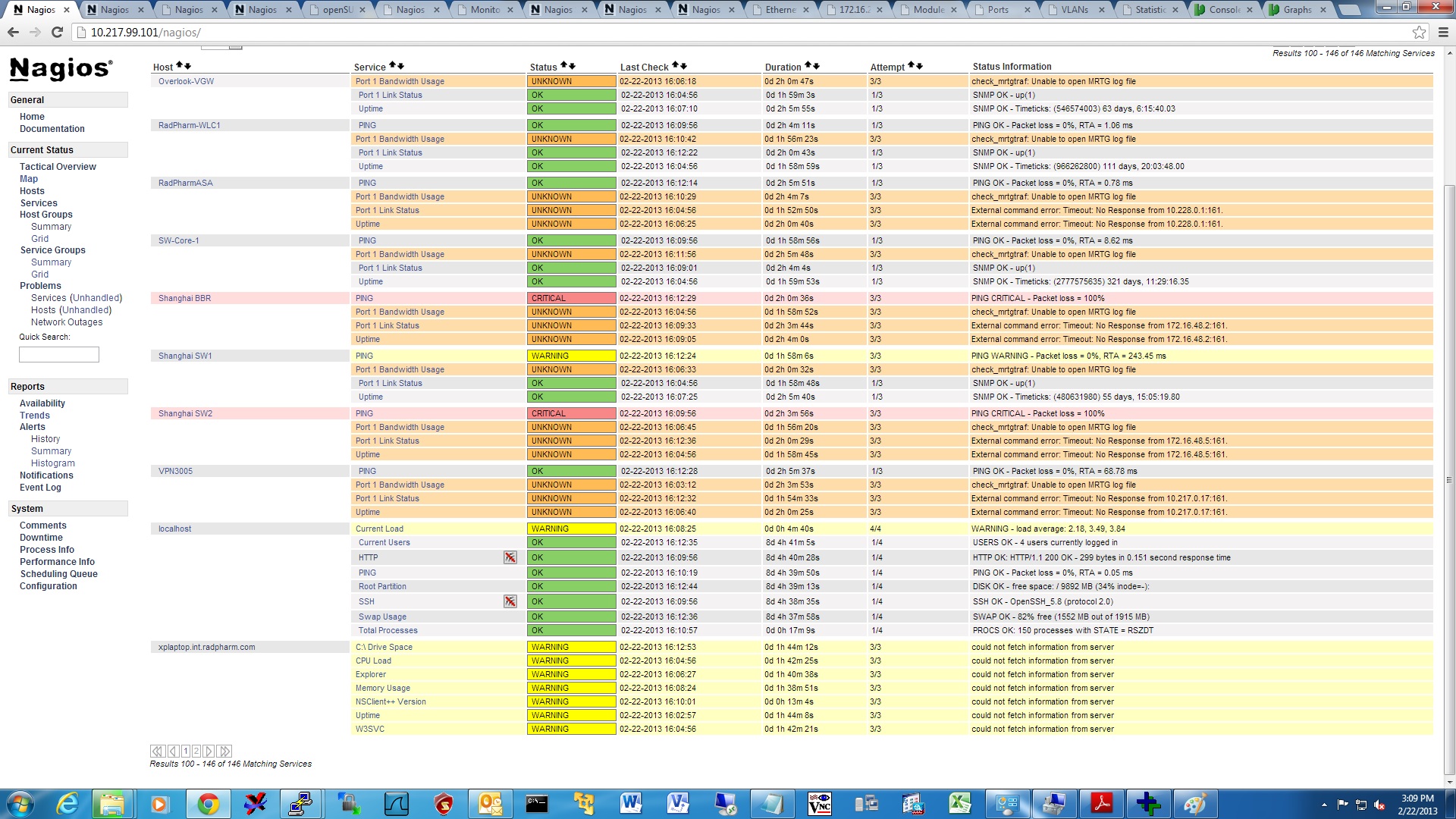

1) I see below that your configurations look good, lets make sure that nagios is actually running though. How have you installed nagios, package or source install?
2) Have you configured nsclient to receive from ipv6 addresses? It would appear that you are being rejected based on its internal IP whitelisting. You mentioned this is "the exact same error", is that just in reference to that it keeps saying the same thing?
3) what url are you attempting to check? Depending on, this could be similarly related to the first issue of the webui not working.
ps aux | grep bin/nagios2) Have you configured nsclient to receive from ipv6 addresses? It would appear that you are being rejected based on its internal IP whitelisting. You mentioned this is "the exact same error", is that just in reference to that it keeps saying the same thing?

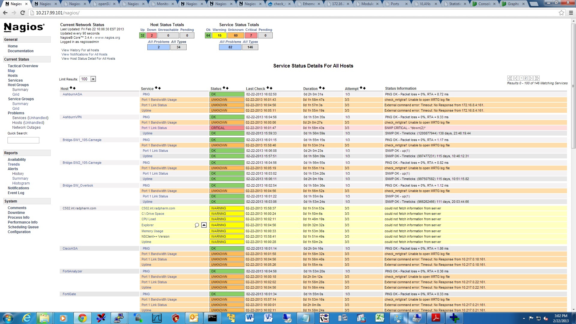

Re: CGI Errors and NSClient++ errors on Windows 7 workstatio
Both xplaptop and c502 are windows machine. NSClient++ and Nagios are not fully retrieving the information. I review all documentation and it seems that I cannot find the nsc.ini file on both Windows XP and Windows 7, just nsclient.ini
- Posts: 7698
NSC.ini and nsclient.ini are the same file, just a different name between versions. Which version of nsclient++ do you have installed? We recommend NSclient++ 3.9.x and not the latest versions as they are not fully bug tested yet.
Have you made sure that the windows firewall is allowing both port 12489 and 5666 through? 12489 is used for check_nt checks, and 5666 for NRPE checks. Also, be sure you allow this traffic on your Nagios Core server's firewall as well. I am assuming since you are using the default checks you will be using 12489 right now for configuration purposes.
