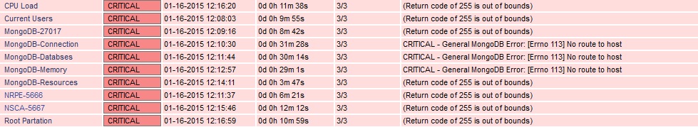

Nagios Monitoring ERROR/BUG
Re: Nagios Monitoring ERROR/BUG
There were some bug fixes that may fix the issue of the Status showing OK when a service check timeouts.
Thanks for everyone support.
My problem resolved after upgrading my nagios from 4.0.4 to 4.0.8, The status goes to CRITICAL from OK. But status information (Return code of 255 is out of bounds) still persist. (as my previous post show the information)
Are all service checks for this host failing?
Can you also post any files in this directory:
Your nrpe.cfg is including this directory.
On the remote host can you type these commands and post the output:
/usr/local/nagios/etc/nrpeOn the remote host can you type these commands and post the output:
ls -al /usr/local/nagios/libexec/
cat /etc/xinetd.d/nrpe
service xinetd statusAs of May 25th, 2018, all communications with Nagios Enterprises and its employees are covered under our new Privacy Policy.
Box293 wrote:Are all service checks for this host failing?
Your nrpe.cfg is including this directory.Code: Select all
ls -al /usr/local/nagios/libexec/ cat /etc/xinetd.d/nrpe service xinetd status
Thanks for the information.
So is the problem you are trying to fix (Return code of 255 is out of bounds) ... is that only happening when your host is down, or does it occur when the host is up?rmuhammadali wrote:My problem resolved after upgrading my nagios from 4.0.4 to 4.0.8, The status goes to CRITICAL from OK. But status information (Return code of 255 is out of bounds) still persist. (as my previous post show the information)
rmuhammadali
- Posts: 27
- Joined: Sat Dec 13, 2014 4:02 am
Yes, the is problem (Return code of 255 is out of bounds) still persist when the host is down, otherwise on host up everything is fine. Snapshot for the services information when host downBox293 wrote:Thanks for the information.
