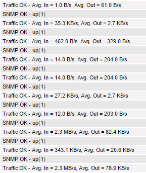

I'm using check_mrtg to get bandwidth/graphs from Cisco switch...
Result are shown in bytes (MB/s) and I would like them in bits? Is it possible?

ok, i checked mrtg.cfg and there was everything in bytes. so i re run cfgmaker with bits
cfgmaker --global 'WorkDir: /var/www/mrtg' --global 'Options[_]: bits' --output /etc/mrtg/mrtg3.cfg [email protected]:::::2
indexmaker --output=/var/www/mrtg/index.html /etc/mrtg/mrtg.cfg
and then checked again with nagios and it is shown with as bytes

I believe this may be a limitation of check_mrtgtraf. From it's usage:
[snip]
If either the incoming or outgoing rates exceed the <icl> or <ocl> thresholds (in
Bytes/sec), a CRITICAL status results. If either of the rates exceed
the <iwl> or <owl> thresholds (in Bytes/sec), a WARNING status results.

Yeah... Will have to chose different plugin to get what I need.
