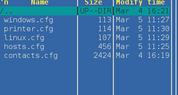

Re: error message template - beginner
this is how my templates folder looks like . hosts= my generic template for hosts.
Thanks again for any help.
Kristine
