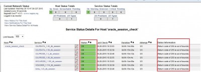

I want to know why the field "Status information" showes "Return code of 255 is out of bounds" and the field "Status" showes "OK".
I check the nagios status file "status.dat" as follow:
servicestatus {
host_name=oracle_session_check
service_description=VOUCHER_1.114_db_session
modified_attributes=0
check_command=check_db_session!VOUCHER_1.114!vcquery!123456
check_period=24x7
notification_period=24x7
check_interval=1800.000000
retry_interval=10.000000
event_handler=
has_been_checked=1
should_be_scheduled=1
check_execution_time=0.057
check_latency=0.000
check_type=0
current_state=255 last_hard_state=255
last_event_id=0
current_event_id=8
current_problem_id=896
last_problem_id=0
current_attempt=3
max_attempts=3
state_type=1
last_state_change=1432085539
last_hard_state_change=1432085559
last_time_ok=1432085539
last_time_warning=0
last_time_unknown=0
last_time_critical=0
plugin_output=(Return code of 255 is out of bounds) long_plugin_output=
performance_data=
last_check=1432107159
next_check=1432108959
check_options=0
current_notification_number=0
current_notification_id=0
last_notification=0
next_notification=0
no_more_notifications=0
notifications_enabled=1
active_checks_enabled=1
passive_checks_enabled=1
event_handler_enabled=1
problem_has_been_acknowledged=0
acknowledgement_type=0
flap_detection_enabled=1
process_performance_data=1
obsess=1
last_update=1432108253
is_flapping=0
percent_state_change=4.67
scheduled_downtime_depth=0
Hope offer me your help! Thank U!

Interesting. It looks like you're using some sort of Oracle plugin? If so, which one?
Are you using check_nrpe or similar to help process these checks?
Finally, if you run the checks manually from the command line, do you get the same results? (OK Return code of 255 is out of bounds)

Everything looks proper, my assumption is that these are not being set:
ORACLE_HOME
LD_LIBRARY_PATH
Check what they should be with the command below:
env
Try adding them to the top of the perl script script under the use statements:
$ENV{'ORACLE_HOME'} = '/your/path';
$ENV{'LD_LIBRARY_PATH'} = 'your/path2';

Thanks. Indeed, the "env" causes.
