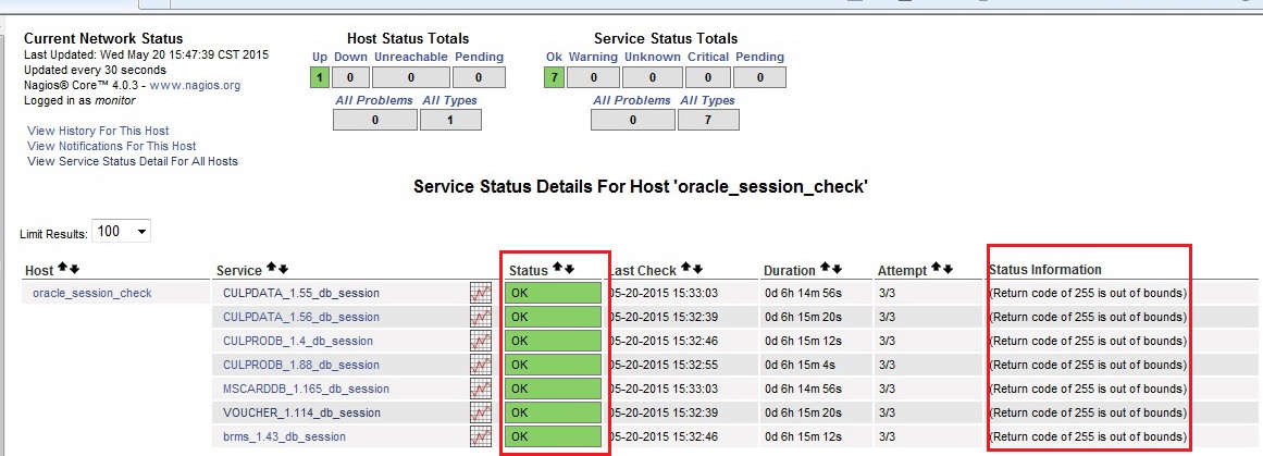

I want to know why the field "Status information" showes "Return code of 255 is out of bounds" and the field "Status" showes "OK".

Re: show "Return code of 255 is out of bounds"
Interesting. It looks like you're using some sort of Oracle plugin? If so, which one?
Are you using check_nrpe or similar to help process these checks?
Finally, if you run the checks manually from the command line, do you get the same results? (OK Return code of 255 is out of bounds)
To jolson:
My detail info of the .cfg files as follow:
my service cfg:
use check_remote
host_name oracle_session_check
alias oracle session check
address 127.0.0.1
contact_groups admins
check_interval 1800
retry_interval 10
service_description VOUCHER_1.114_db_session
check_command check_db_session!VOUCHER_1.114!vcquery!123456
command.cfg:
#check_db_session
command_name check_db_session
command_line check_db_session
command_line $USER1$/check_db_session.pl $ARG1$ $ARG2$ $ARG3$
resource.cfg:
$USER1$=/home/nagios/monitor/nagios/libexec
This is the output that I run the script mannually from the command line:
[nagios@a1a162 ~]$ /home/nagios/monitor/nagios/libexec/check_db_session.pl VOUCHER_1.114 vcquery 123456
****: HOST->a1a75.rh6.sh OS_USER->culws DB_USER->VOUCHER PRO->JDBCThinClient Normal[1] != 2
****: HOST->a1a151.rh6.sh OS_USER->culws DB_USER->VOUCHER PRO->JDBCThinClient Normal[1] != 2
****: HOST->voucher-appweb OS_USER->voucher DB_USER->VOUCHER PRO->JDBCThinClient Normal[5] != 6
VOUCHER_1.114 OK!
------Check End.
[nagios@a1a162 ~]$ echo $?
0
[nagios@a1a162 ~]$ id
uid=500(nagios) gid=500(nagios) groups=500(nagios)
[nagios@a1a162 ~]$
Could you upload the check_db_session.pl script to this post so we can review it?
Everything looks proper, my assumption is that these are not being set:
ORACLE_HOME
LD_LIBRARY_PATH
Check what they should be with the command below:
Try adding them to the top of the perl script script under the use statements:
ORACLE_HOME
LD_LIBRARY_PATH
envCode: Select all
$ENV{'ORACLE_HOME'} = '/your/path';
$ENV{'LD_LIBRARY_PATH'} = 'your/path2';
Thanks. Indeed, the "env" causes.
