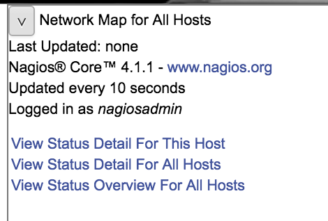

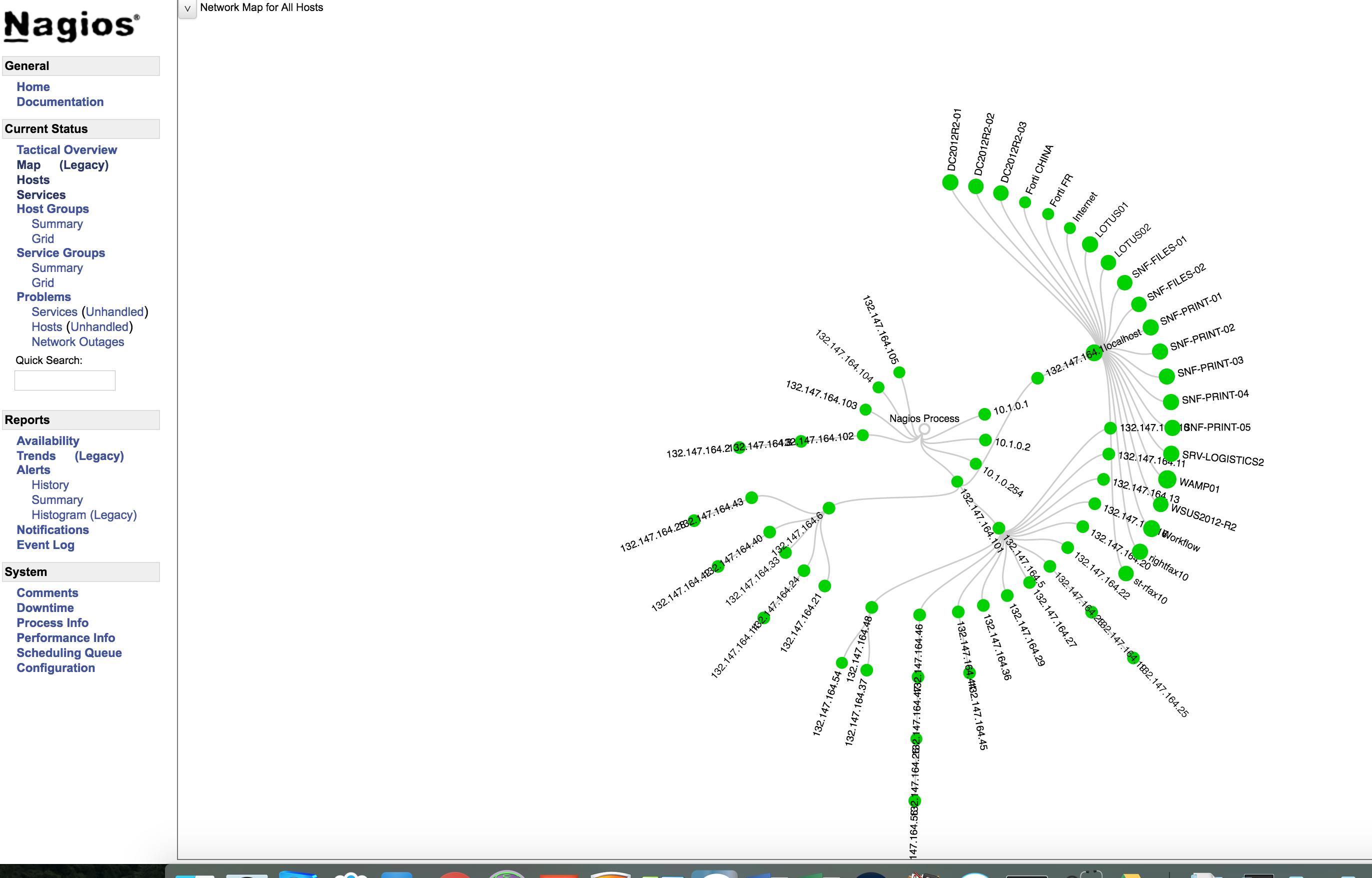

Sorry, my last message was not complete :
When I go to Map, I only see blank, but If I open "Network Map for All Hosts", I've this :

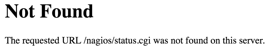

And If I click on the three lines, I've an error "NOT FOUND" :

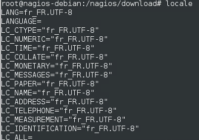

What are your locale/language settings on the server?
locale

The output of locale :
