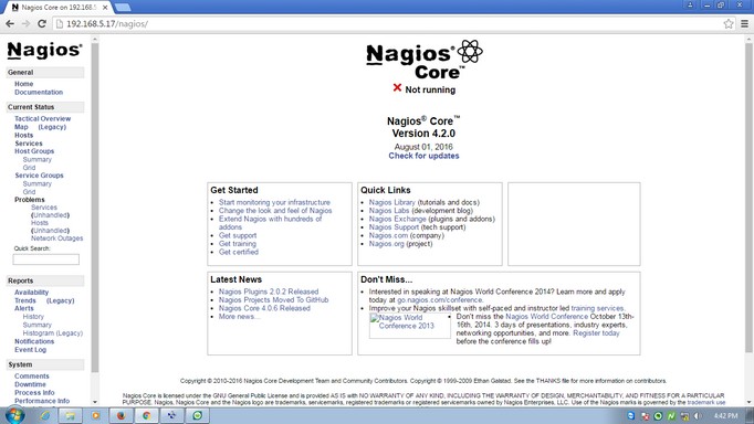

Hi !
Newly I'm trying to configure monitor server with CentOS 7. I installed Nagios-4.2.1 primarily. Before server restart the nagios service was run good. but after restarting the server Nagios Service failed start. please help me for correct.

Re: Nagios Start FAILED
Can you show us the contents of your /usr/local/nagios/etc/nagios.cfg file?
Can you also share the outputs of:
ls -al /usr/local/nagios/var/
ls -al /usr/local/nagios/var/spool/
