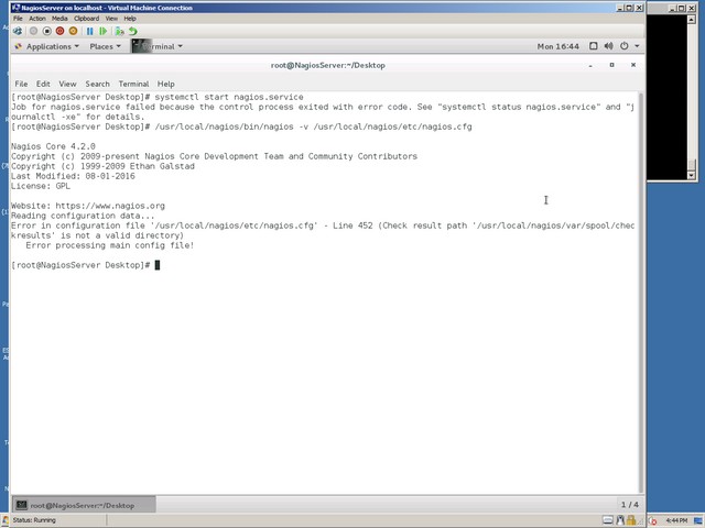

[root@NagiosServer ~]# /usr/local/nagios/bin/nagios -v /usr/local/nagios/etc/nagios.cfg
Nagios Core 4.2.1
Last Modified: 09-06-2016
License: GPL
Reading configuration data...
Error in configuration file '/usr/local/nagios/etc/nagios.cfg' - Line 452 (Check result path '/usr/local/nagios/var/spool/checkresults' is not a valid directory)
Error processing main config file!

Hi !
Newly I'm trying to configure monitor server with CentOS 7. I installed Nagios-4.2.1 primarily. Before server restart the nagios service was run good. but after restarting the server Nagios Service failed start. please help me for correct.
Nagios Core 4.2.1
License: GPL
