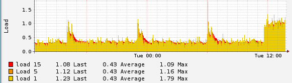

As a final additional point for now, looking at the load profile on my 4.2.1 host it does look like those peaks are still there, albeit on a significantly lower scale.

I've not done any in depth tuning yet - but I'm a long time Nagios user through various versions and it's the first time I've encountered any hosts with this sort of peaky load pattern which settles back down into nothing. My thinking is that if I was seeing genuine performance issues then I would expect the box to have perpetually large 5 and 15 minute load averages. Having said that, at first glance I believe most of the recommendations on the tuning page are already in place.
The good news is that after a day of running my 4.0.8 servers with auto_reschedule_checks enabled with an auto_rescheduling_window set to 45 the load profile of the servers look much better. I am still seeing slight peaks on a ~7 hour schedule though which still makes me think there is something happening behind the scenes that may cause problems down the line.
