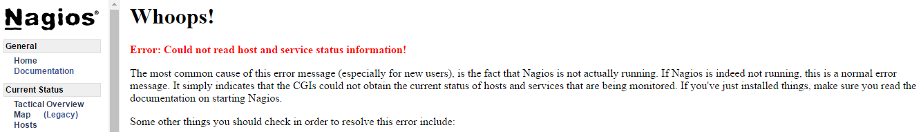

There is one more thing....I am now getting the following after I added a windows host.
Re: Stuck at the start
Please post the output of these commands:
Try to restart the nagios service:
Then if it fails, send us the output of this command:
Thank you
chage -l nagios
sestatus
grep nag /etc/group
grep "User \|Group " /etc/httpd/conf.d/nagios
service nagios status
ps aux |grep nagios.cfgCode: Select all
service nagios restartCode: Select all
tail -n100 /var/log/messages /usr/local/nagios/var/nagios.log
