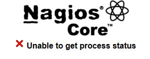

And as I go to the nagios page I have a message:
unable to get process status [\b] (attachment)
Is this also the error associated with the above?
