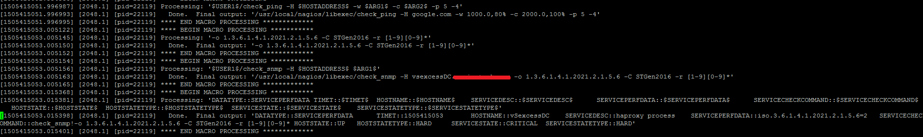

I'm not sure if this helps but here is a screenshot of the debug log file:

Can you post your commands.cfg (or wherever you have your commands defined)?

Here is a print screen of the check_snmp command definition:
Thanks!
Re: Status critical
I believe the -r is for matching sting values, but that OID returns an INTEGER32
