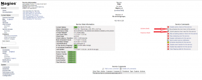

Please go to your command line and run the command below:
For Centos 7...cat /usr/local/nagios/var/rw/nagios.cmd
For Centos 6...tail -f /usr/local/nagios/var/rw/nagios.cmd
Then go to your Nagios Core Web UI and submit a passive and an active check on a service as you watch the output from the command line.
Step 2
Secondly, please go to your command line and run the following command...tail -f /var/log/httpd/access_log
Then go to your Nagios Core Web UI and submit a passive check and an active check on a service as you watch the output from the command line.

dwasswa wrote:Hi @invade,
Please follow the steps below and attach a file with output from each step.
Step 1
Step 2
Example:
The attachment Nagios_checks.PNG is no longer available
Lastly, please attach a copy of your nagios.cfg file located at /usr/local/nagios/etc/nagios.cfg (or wherever you have it located).
