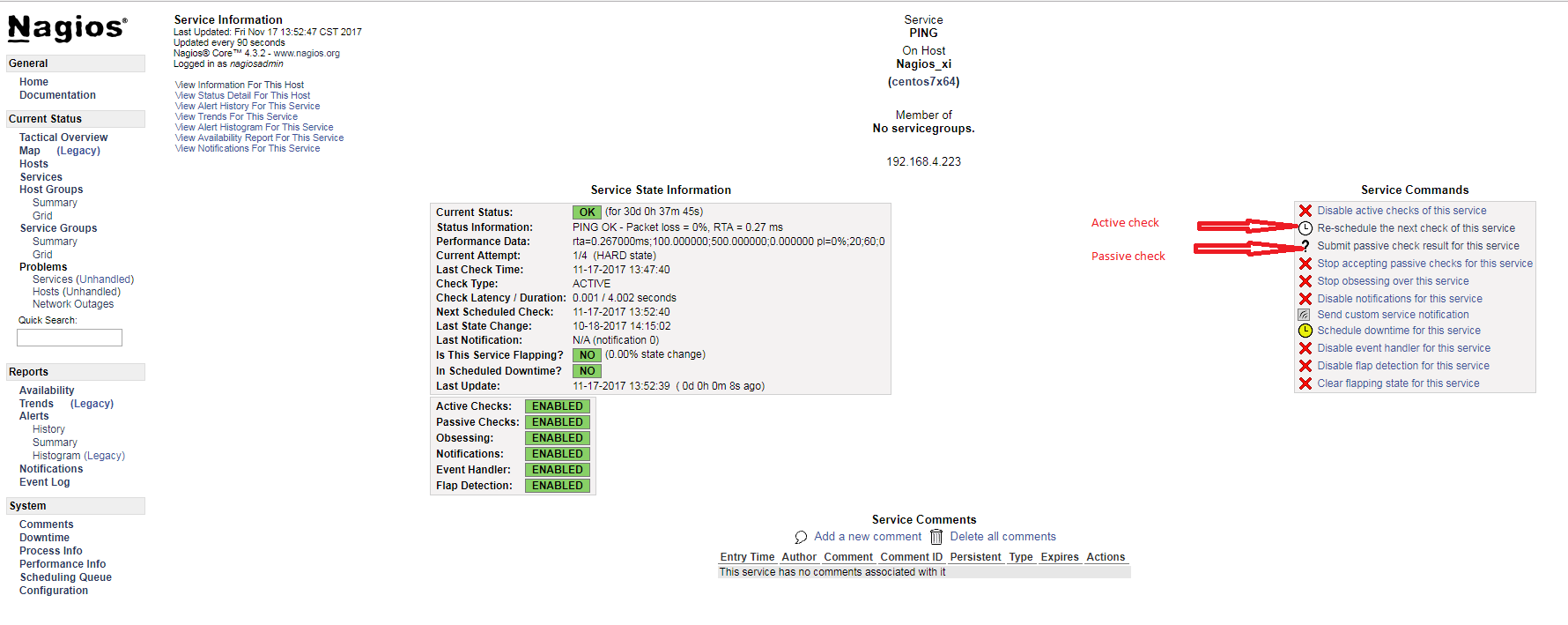

Then go to your Nagios Core Web UI and submit a passive and an active check on a service as you watch the output from the command line.
