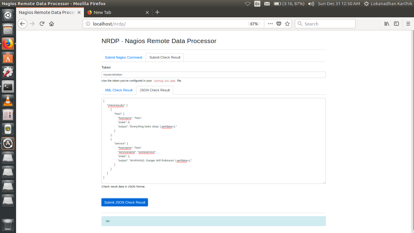

I have NRDP configured with Nagios core. Passive host and service checks are not getting processed by NRDP. I don't see them in nagios.cmd nor in nagios.log, no errors while submitting from http://localhost/nrdp
But, the downtime requests are getting processed and i'm seeing them in the nagios.cmd file. What could be missing?

That's the thing here. No errors. Just a OK at the bottom and that too disappears soon,

If i submit the command, it's not showing any output, just a blank page. Any thoughts?

It looks like there was a fix/pull that was mentioned on the NRDP Github.
https://github.com/NagiosEnterprises/nrdp/pull/30
You could use the pull request, or just don't use the default JSON format which is fine too.
Trying sending a check with something like this against, on a host/service you have for passive checks.
Once you submit it with this format, try a tail and see if it worked.
Here's my example.
Let us know!
