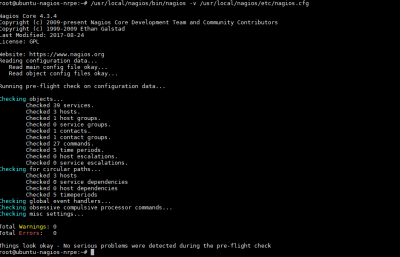

Postby npolovenko » Mon Feb 12, 2018 12:13 pm
@skypete, Well, we need to figure out what's wrong with the old service command. Please run these two commands:
service nagios restart
And show me the output of both commands please, without this information I will not be able to figure out what's going on.
npolovenko
Posts: 3457
Postby skypete » Mon Feb 12, 2018 1:47 pm
Here you Go hope this helps.
skypete
Posts: 98
Joined: Sat Dec 02, 2017 11:44 pm
