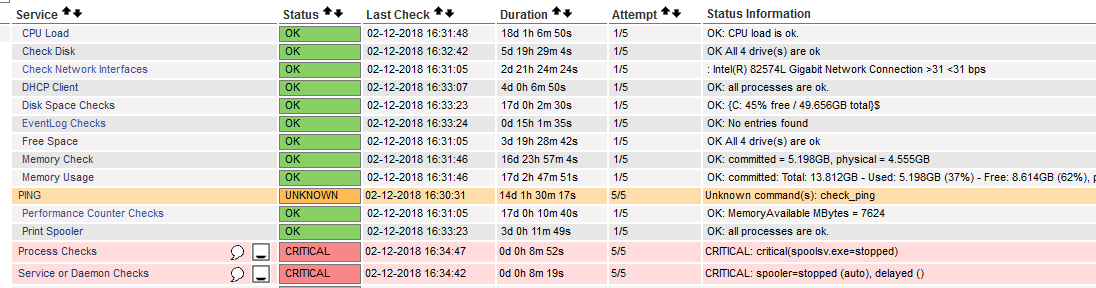

Please send me the screenshot from the Nagios Core web interface of this service in a critical state.

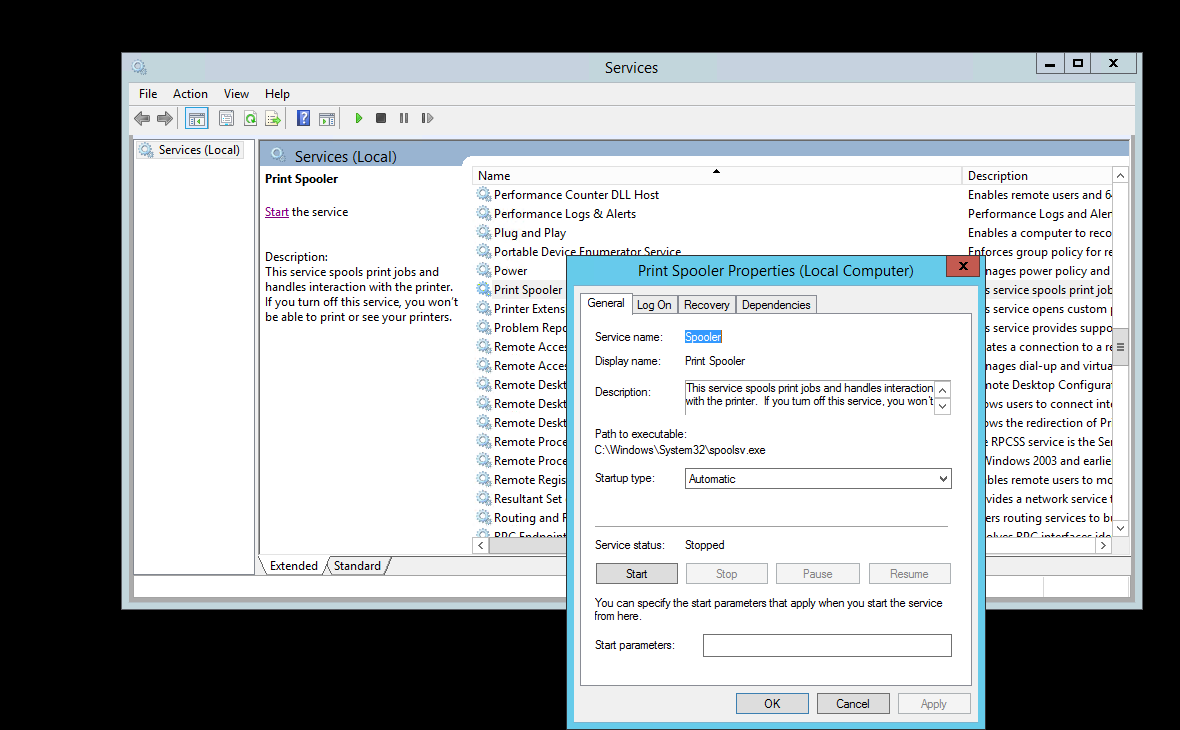

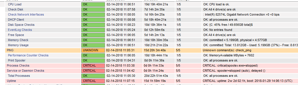

Thanks for your help i did add those commands. I checked the windows server and it did not restart the service it still shows it as stopped, Another thing you asked when the service turns green if the windows service is up and it turns red when the windows service is down the print spooler service stays green on the nagios ui but the service or daemon checks and process check are changed to red. Here is my service commands and screens shots of the windows server and nagios web UI. Thanks

Hi and thanks again the service never worked nor has it ever been in any critical state nor has it represented the actual state of a windows process ever and it does not go red ever. When I stop the service from the windows servers. It will only work when i ran the /usr/local/nagios/libexec/check_nrpe -H (IP Adress of server) -c restart_service -a spooler than it will go back to its current state.
Has for the testing.txt all it has in the file is Event Handler Works! at the moment.
