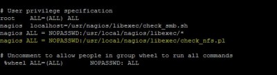

shamrozkadiwal wrote: I put sudo in front of $USER1$/check_nfs.pl -H $HOSTADDRESS$ and restart the nagios. nothing happened
I really think you need the following line in your sudoers file
nagios ALL = NOPASSWD:/usr/local/nagios/libexec/check_nfs.pl
Also, are you sure this is the command this service is using?

by shamrozkadiwal » Fri Oct 05, 2018 3:06 pm
no luck again and still seeing unknown error.
I checked service command "check_nfs" and it is pointing to check_nfs.pl
