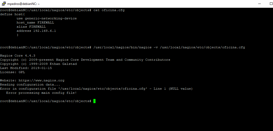

Hi:
I just installed the version of Nagios Core 4.4.3, make a very simple configuration and I can not find the error ...
Configure 1 single host with only one service:
root@debianNC:/usr/local/nagios/etc/objects# cat oficina.cfg
use generic-host
host_name FIREWALL
alias Firewall
address 192.168.6.1
host_name FIREWALL
service_description Ping
check_command check_ping!60.0,5%!100.0,10%
Add the file "oficina.cfg" to the file "nagios.cfg":
cfg_file=/usr/local/nagios/etc/objects/commands.cfg
cfg_file=/usr/local/nagios/etc/objects/contacts.cfg
cfg_file=/usr/local/nagios/etc/objects/timeperiods.cfg
cfg_file=/usr/local/nagios/etc/objects/templates.cfg
cfg_file=/usr/local/nagios/etc/objects/oficina.cfg
And when verifying it gives me the following errors:
root@debianNC:/usr/local/nagios/etc# /usr/local/nagios/bin/nagios -v /usr/local/nagios/etc/objects/oficina.cfg
Nagios Core 4.4.3
Last Modified: 2019-01-15
License: GPL
Reading configuration data...
Error in configuration file '/usr/local/nagios/etc/objects/oficina.cfg' - Line 1 (NULL value)
Error processing main config file!
root@debianNC:/usr/local/nagios/etc# /usr/local/nagios/bin/nagios -v /usr/local/nagios/etc/nagios.cfg
Nagios Core 4.4.3
License: GPL
Read main config file okay...
Error: Cannot open config file '/usr/local/nagios/etc/objects/baxo.cfg' for reading: No such file or directory
Error: Invalid max_check_attempts value for host 'FIREWALL'
Error: Could not register host (config file '/usr/local/nagios/etc/objects/oficina.cfg', starting on line 1)
directives and data definitions. If you are upgrading from a previous
Can someone help me that I can not identify the error?
Thank you very much in advance!
Martin Pedros
What is the output of this command:
ls -l /usr/local/nagios/etc/objects
Try changing it to:
define host {
use generic-host
host_name FIREWALL
alias Firewall
check_interval 5
max_check_attempts 5
retry_interval 1
address 192.168.6.1

Hi ssax:
Thank you very much for your prompt response. I made the requested changes and I continue with the same error:
root@debianNC:/usr/local/nagios/etc/objects# ls -l /usr/local/nagios/etc/objects
total 60
-rw-rw-r-- 1 nagios nagios  6747 abr  8 16:46 commands.cfg
-rw-rw-r-- 1 nagios nagios  1797 abr  8 16:46 contacts.cfg
-rw-rw-r-- 1 nagios nagios  4777 abr  8 16:46 localhost.cfg
-rw-r--r-- 1 root   nagios   142 abr 12 08:56 oficina.cfg
-rw-rw-r-- 1 nagios nagios  3001 abr  8 16:46 printer.cfg
-rw-rw-r-- 1 nagios nagios  3484 abr  8 16:46 switch.cfg
-rw-r--r-- 1 root   nagios  1088 abr 11 11:19 templates_baxo.cfg
-rw-rw-r-- 1 nagios nagios 12533 abr  8 16:46 templates.cfg
-rw-rw-r-- 1 nagios nagios  3512 abr  8 16:46 timeperiods.cfg
-rw-rw-r-- 1 nagios nagios  4074 abr  8 16:46 windows.cfg
define host {
use generic-host
host_name FIREWALL
alias Firewall
check_interval 5
retry_interval 1
address 192.168.6.1
root@debianNC:/usr/local/nagios/etc/objects# /usr/local/nagios/bin/nagios -v /usr/local/nagios/etc/objects/oficina.cfg
Nagios Core 4.4.3
License: GPL
root@debianNC:/usr/local/nagios/etc/objects# /usr/local/nagios/bin/nagios -v /usr/local/nagios/etc/nagios.cfg
Nagios Core 4.4.3
License: GPL
Error: Invalid max_check_attempts value for host 'localhost'
Error: Could not register host (config file '/usr/local/nagios/etc/objects/localhost.cfg', starting on line 21)
     may have been removed or modified in this version.  Make sure to read
Thanks,
Martin Pedros

Ssax:
I add a test that I did, the same configuration in the Nagios Core of my house works well, the only difference is that I have the version Nagios Core 4.4.0, will there be a problem with version 4.4.3? Attached captures:
Home Config:
Office config:
Thanks,
Martin Pedros
Office Config
Office Config
Home
Home
Home Config
Home Config
Martin Pedros
Re: Error in a simple config on Nagios Core 4.4.3
Lets reset the permissions on the config file and make sure there are not any hidden characters in the file.
Run this as root to do that.
chown nagios.nagios /usr/local/nagios/etc/objects/oficina.cfg
cmmod 664 /usr/local/nagios/etc/objects/oficina.cfg
Install the dos2unix application on the server and run this to clear then out.
dos2unix /usr/local/nagios/etc/objects/oficina.cfg
See if that helps.
If not, can you get all of the config files from the server, zip them up and upload them to the post so we can view them?
The error may be coming from the template file.

Hi Tgriep:
The commands did not work for me. I attach the requested files.
Thanks in advance!
Martin Pedros
nagios-core-443.tar
Files
(92 KiB) Downloaded 199 times
Martin Pedros
Thanks for the files.
In the oficina.cfg file you are specifying a template called generic-networking-device but that template does not exist is any of the other templates.
Edit the template.cfg file and add this example to it. Save it and restart nagios to see if it runs now.
define host {
  name                           generic-networking-device           ; The name of this host template
  use                            generic-host                        ; This template inherits other values from the generic-host template
  check_command                  check-host-alive                    ; Default command to check Linux hosts
  check_interval                 5                                   ; Actively check the host every 5 minutes
  check_period                   24x7
  contact_groups                 admins                              ; Notifications get sent to the admins by default
  notification_interval          120                                 ; Resend notifications every 2 hours
  notification_options           d,u,r                               ; Only send notifications for specific host states
  notification_period            24x7
  register                       0                                   ; DONT REGISTER THIS DEFINITION - ITS NOT A REAL HOST, JUST A TEMPLATE!
  retry_interval                 1                                   ; Schedule host check retries at 1 minute intervals

Hi Tgriep:
Sorry for the delay. I've tried it and it's the same error. In the next few days I will be a bit complicated to move forward with the tests, if you want to close this case. As soon as I can, I will resume the tests. Thank you very much for all the support.
Regards,
Martin Pedros
Martin Pedros
One more thing to try.
You have this configuration file in the nagios.cfg
cfg_file=/usr/local/nagios/etc/objects/baxo.cfg
But the file did not exist in the archive file from your previous post.
Remove that line from the nagios.cfg file and see if that fixes the issue.

Hi Tgriep:
I had already verified that and I still have the same problem. What I do not understand is why I get that null error, and if I commented everything, it gives me the logical error that it is not in my account or host and service.
        use generic-networking-device
        host_name FIREWALL
        alias FIREWALL
        address 192.168.6.1
        host_name FIREWALL
Nagios Core 4.4.3
License: GPL
Checking objects...
        Checked 9 services.
        Checked 2 hosts.
        Checked 1 host groups.
        Checked 0 service groups.
        Checked 1 contacts.
        Checked 1 contact groups.
        Checked 24 commands.
        Checked 5 time periods.
        Checked 0 host escalations.
        Checked 2 hosts
        Checked 0 host dependencies
        Checked 5 timeperiods
Checking misc settings...
Total Warnings: 0
Total Errors:   0
Nagios Core 4.4.3
License: GPL
#define host{
#        use generic-networking-device
#        host_name FIREWALL
#        alias FIREWALL
#        address 192.168.6.1
#define service{
#        use generic-service
#        service_description Ping
#        check_command check_ping!60.0,5%!100.0,10%
Nagios Core 4.4.3
License: GPL
Checking objects...
Error: There are no services defined!
        Checked 0 services.
Error: There are no hosts defined!
        Checked 0 hosts.
        Checked 0 host groups.
Error: There are no contacts defined!
        Checked 0 contacts.
        Checked 0 contact groups.
        Checked 0 commands.
        Checked 0 time periods.
        Checked 0 hosts
        Checked 0 timeperiods
Warning: Nothing specified for illegal_macro_output_chars variable!
Total Warnings: 1
Total Errors:   3
***> One or more problems was encountered while running the pre-flight check...
