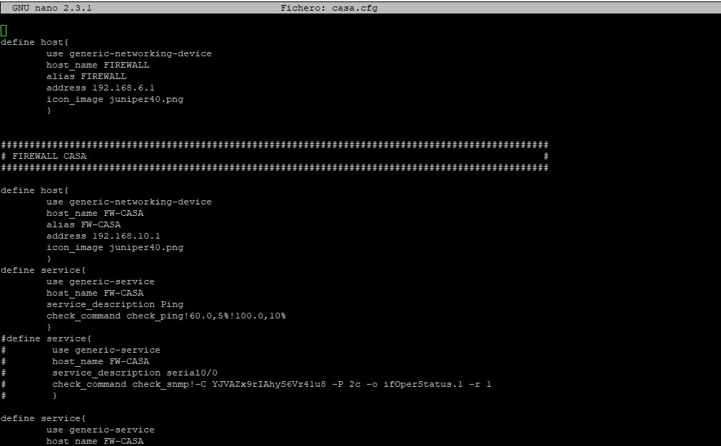

Re: Error in a simple config on Nagios Core 4.4.3
Ssax:
I add a test that I did, the same configuration in the Nagios Core of my house works well, the only difference is that I have the version Nagios Core 4.4.0, will there be a problem with version 4.4.3? Attached captures:
Home Config:
Office config:
Thanks,
Martin Pedros
Home Config:
Office config:
Thanks,
Martin Pedros

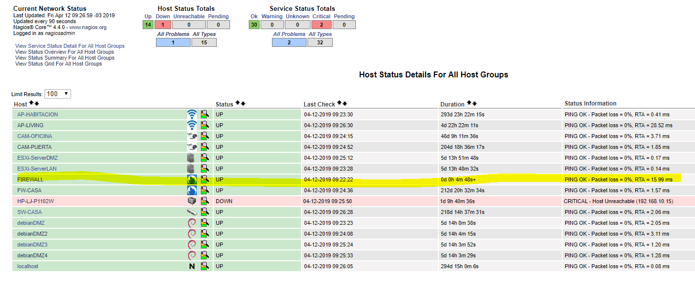

Hi Tgriep:
I had already verified that and I still have the same problem. What I do not understand is why I get that null error, and if I commented everything, it gives me the logical error that it is not in my account or host and service.
root@debianNC:/usr/local/nagios/etc/objects# cat oficina.cfg
use generic-networking-device
host_name FIREWALL
alias FIREWALL
address 192.168.6.1
host_name FIREWALL
service_description Ping
check_command check_ping!60.0,5%!100.0,10%
root@debianNC:/usr/local/nagios/etc/objects# /usr/local/nagios/bin/nagios -v /usr/local/nagios/etc/nagios.cfg
Nagios Core 4.4.3
Last Modified: 2019-01-15
License: GPL
Reading configuration data...
Read main config file okay...
Checking objects...
Checked 9 services.
Checked 2 hosts.
Checked 1 host groups.
Checked 0 service groups.
Checked 1 contacts.
Checked 1 contact groups.

root@debianNC:/usr/local/nagios/etc/objects#Code: Select all
#define host{
# use generic-networking-device
# host_name FIREWALL
# alias FIREWALL
# address 192.168.6.1
#define service{
# use generic-service
# service_description Ping
# check_command check_ping!60.0,5%!100.0,10%
root@debianNC:/usr/local/nagios/etc/objects# /usr/local/nagios/bin/nagios -v /usr/local/nagios/etc/objects/oficina.cfg
Nagios Core 4.4.3
License: GPL
Checking objects...
Error: There are no services defined!
Checked 0 services.
Error: There are no hosts defined!
Checked 0 hosts.
Checked 0 host groups.
Error: There are no contacts defined!
Checked 0 contacts.
Checked 0 contact groups.
Checked 0 commands.
Checked 0 time periods.
Checked 0 host escalations.
Checked 0 hosts
Checked 0 host dependencies
Checked 0 timeperiods
Checking misc settings...
Warning: Nothing specified for illegal_macro_output_chars variable!
Total Warnings: 1
Total Errors: 3
***> One or more problems was encountered while running the pre-flight check...
directives and data definitions. If you are upgrading from a previous
