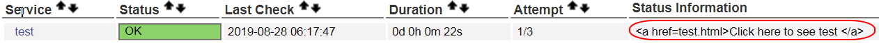

Is it possible to add a URL link to the status information column。
I try to write a simple perl script~
printf(" \<a href=test.html\>Click here to see test \</a\>")
but nagios shows like
this is I want~
Status information
Anybody knows how to slove it

I did see someone using the hyperlink in the status information field of the nagios core V3.5. Just, I don't know how he does it. The result of my test, nagios does not Interpret the HTML , or What plug-in do I need to install?
Re: Add a URL link to the status information
Oh, you can edit the cgi.cfg
change this
escape_html_tags=1
to this
escape_html_tags=0

It's working :D
thanks again
