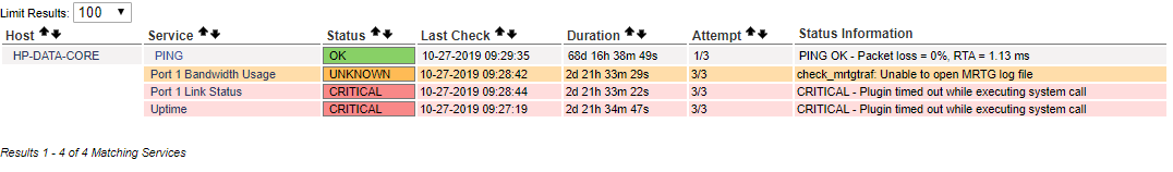

I want to monitor my switch using MRTG, but something is not well configured, I followed some of the topics for the error that I have which is : "check_mrtgtraf: Unable to open MRTG log file "
knowing that /var/www/mrtg contains some interface logs
I read in some forums that /var/lib/mrtg/ must contain the log file that nagios reads, but in my case it contains only cfg files
can you guys help me through this config

This is the service conftgriep wrote:Can you post the Nagios configuration you are using for the Port 1 Bandwidth Usage check?
Did you setup a cron job to run the MRTG application which gathers the Bandwidth information the check_mrtgtraf plugin needs to calculate the bandwidth?
Check this link for instructions for MRTG.
https://oss.oetiker.ch/mrtg/doc/mrtg-unix-guide.en.html
If you run the following as root, it will run the MRTG application in debug mode which you can use to troubleshoot the MRTG application.
# Monitor bandwidth via MRTG logs
use generic-service ; Inherit values from a template
host_name HP-DATA-CORE
service_description Port 1 Bandwidth Usage
check_command check_local_mrtgtraf!/var/lib/mrtg/172.20.232.1_1.log!AVG!1000000,1000000!5000000,5000000!10
}Code: Select all
command_name check_local_mrtgtraf
command_line $USER1$/check_mrtgtraf -F $ARG1$ -a $ARG2$ -w $ARG3$ -c $ARG4$ -e $ARG5$
}Code: Select all
*/5 * * * * /usr/bin/env LANG=C /usr/bin/mrtg /etc/mrtg/mymrtg.cfg –logging /var/log/mrtg.log
*/5 * * * * /usr/bin/env LANG=C /usr/bin/mrtg /etc/httpd/conf/mrtg.cfg --logging /var/log/mrtg.log
