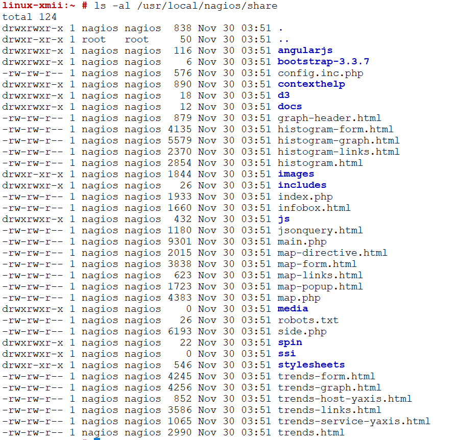

what are the permissions here
Do you see errors in the apache error log?
ls -al /usr/local/nagios/share-

Please find attached "error_log" and "ls -al /usr/local/nagios/share" output.
I see few failures in "error"log".

- DevOps Engineer
- Posts: 19396
Re: Unable to open Nagios Core console on setup created on S
Ok, you are getting
This leads me to believe php isn't installed
Did you install the prerequisites here?
https://support.nagios.com/kb/article/n ... .html#SUSE
No matching DirectoryIndex (index.html,index.html.var)Did you install the prerequisites here?
