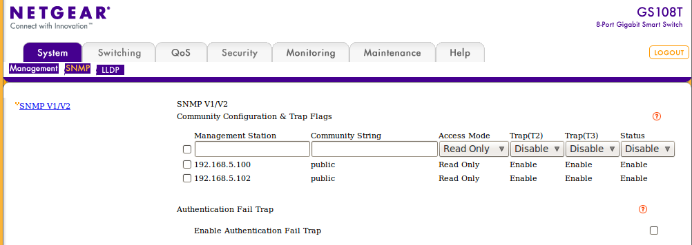

I think this is all just done on the device end, and so you'd need to check the documentation for that. For instance, here's what it looks like for our Netgear switches:
I don't think there's any Nagios-end config about community strings when working with traps. Also, here's a config example for the service:
