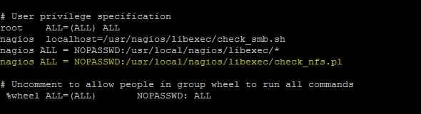

shamrozkadiwal wrote:I put sudo in front of $USER1$/check_nfs.pl -H $HOSTADDRESS$ and restart the nagios. nothing happened :(
I really think you need the following line in your sudoers file
nagios ALL = NOPASSWD:/usr/local/nagios/libexec/check_nfs.pl
Also, are you sure this is the command this service is using?
