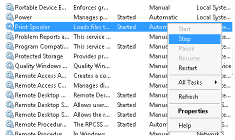

kyang
Let me know if you run into any troubles.Could you direct me on a simple service restart that you know would work something common and explain step by step sorry for the trouble
1. To test simply stop the Print Spooler service on the Windows machine.
2. Open the Services console under "Administrative Tools."
3. Right-click the Print Spooler service and select "Stop." 4. Wait for the service to go to a "critical state" or "force the next check" in the Nagios Core interface.
5. Once the Nagios Core Print Spooler service is in a "critical state" the event handler will be executed and the Windows Print Spooler service will be restarted.
The next time Nagios Core checks the Print Spooler service.
It should to an OK state as the Windows Print Spooler service will now be running.
Or look back in Windows and check if the Printer Spooler service is turned back on by right-clicking it.
6. If the event handler does not appear to be working as expected, check the /usr/local/nagios/var/nagios.log file for any errors.

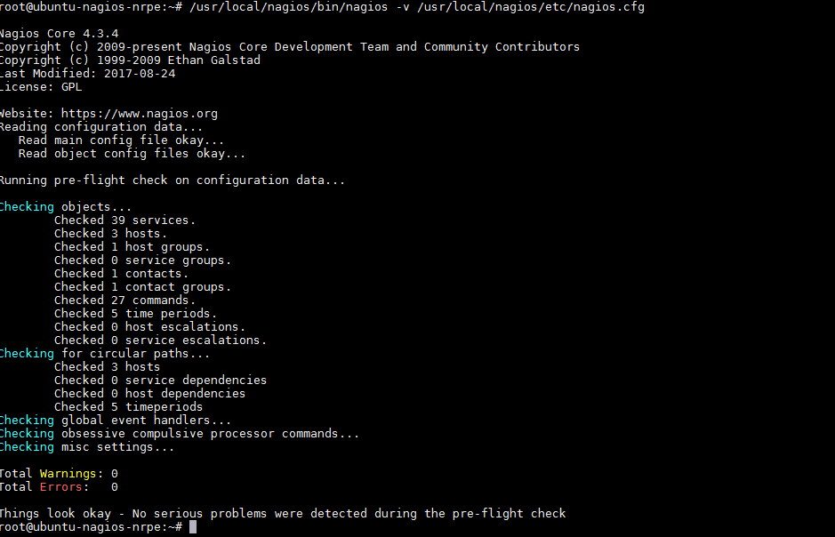

npolovenko
- Support Tech
- Posts: 3457
Please run this command and share the output in your next post:Hi i readded this command and rename it as the following in my cfg file it is not working nagios wont restart the service.
/usr/local/nagios/bin/nagios -v /usr/local/nagios/etc/nagios.cfgCode: Select all
/usr/local/nagios/libexec/check_nrpe -H windows_server_ip_address -p 5666 -c restart_service -a service_nameAs of May 25th, 2018, all communications with Nagios Enterprises and its employees are covered under our new Privacy Policy.

@skypete, Well, we need to figure out what's wrong with the old service command. Please run these two commands:
And show me the output of both commands please, without this information I will not be able to figure out what's going on.
service nagios restart
/usr/local/nagios/bin/nagios -v /usr/local/nagios/etc/nagios.cfgAs of May 25th, 2018, all communications with Nagios Enterprises and its employees are covered under our new Privacy Policy.
