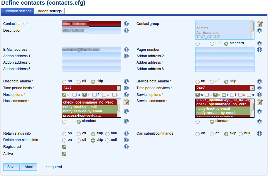

Hi John,
I spent some time looking at this today and I think your problem is related to your contact definitions. Specifically you have host and service commands assigned to "host commands" and host and service commands assigned to "service commands".
All of your contacts should be updated so they ONLY have host commands assigned to "host commands" and service commands assigned to "service commands".
This screenshot from your VM shows what I am explaining:
