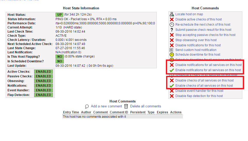

HI, I have 145 hosts.
Out of that, 7 hosts I have switched off knowingly for some POPs, which will be on after few days, so I dont want to remove anything, but just switch off.
How do I switch off the email alerts ?
Its flooding crazy my email inbox.
How to switch off alerts of hosts ?
Re: How to switch off alerts of hosts ?
You should have options under a host's details for disabling all the service notifications (or the active checks themselves):
Is this what you're looking for?
That worked.
Wonderful.
