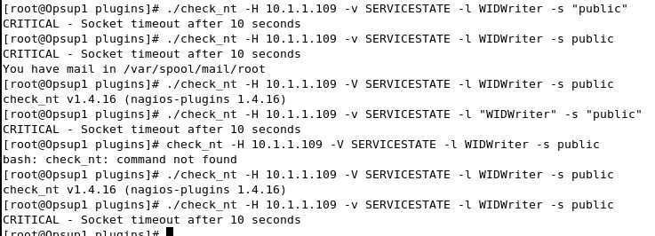

But one question when i try to run any command manually from the command line then it is giving me the error as follows:
Critical: Socket Timeout After 10 seconds
I am getting the above error for all the service definitions even they are reporting to Nagios Fine.
What could be the reason?

Can you give an example of your command you are running from the command line??amitgupta19 wrote:Thanks for pointing me to the Thread.
I was able to resolve the issue by defining the service name in the resource.cfg file .
Then i mentioned that variable in the service definition.
Just remember you cannot pass anything like $ARG1$ when testing from the command line, these need to be replaced with their actual values.

The top one looks right but you likely needs -p 12489 added to the command to set the normal port that nsclient++ uses
