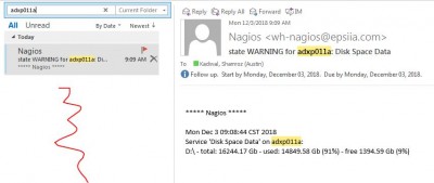

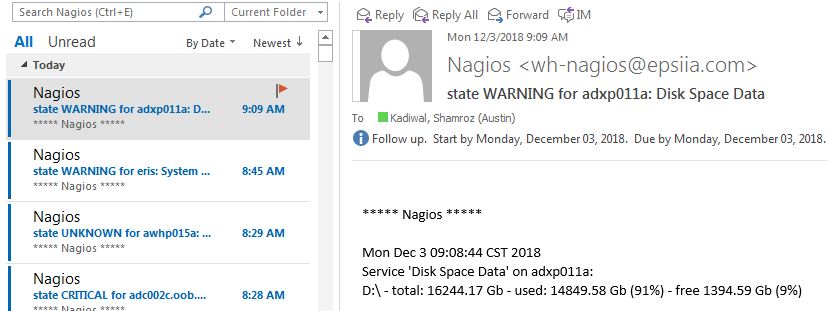

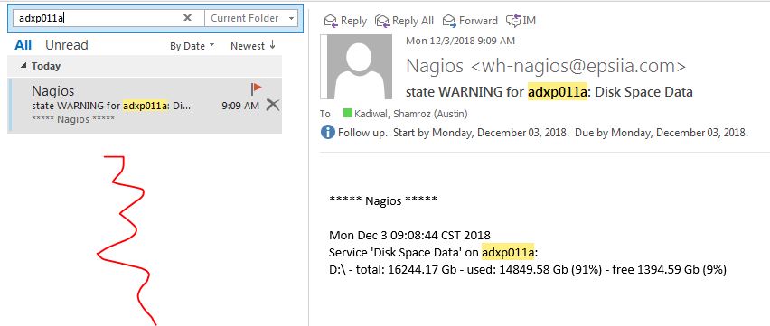

Hey Benjamin,
You asked me couple of things. First, I have attached the contact.cfg file and paste generic-data host template.
Second, I tried Custom Service Notification and it worked. I mean I received the email [Picture attached]. However, If you noticed that I sent another picture of my inbox which indicates that I had never received adxp011a alert email before , so It means email part is working when we commit service notification.
In addition, I didn't find any errors in the /var/log/maillog, but I found few records after I ran the Custom Service Notification with no errors.
